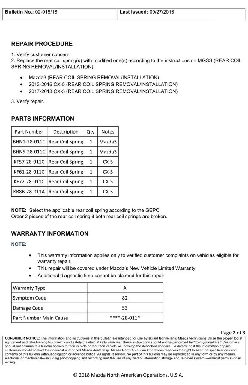

FYI, I did find there was a service bulletin regarding an issue with the rear spring coils:

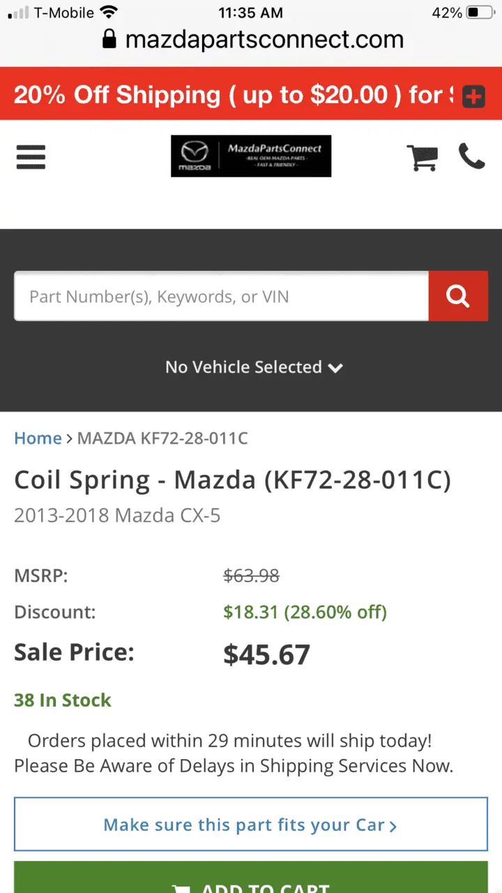

At least this Mazda dealer claims they have 38 in stock. Give it a try.
Should be able to source one at a junk yard I would think
I tried one of those sites before, and it showed stock, so I placed the order. They immediately contacted me saying the part was back-ordered. I will try this site, but I'm expecting the same result since the site looks very similar.

Based on the TSB there’re 4 different part numbers on the rear coil spring for 2013 ~ 2018 CX-5’s. I’d imagine OP got his correct part number from his Mazda dealer based on the VIN. If he’s going to get the rear coil spring from a salvage yard, it’s hard to verify which coil spring he’d be receiving. Or may be to get a pair at least they should match each other.
