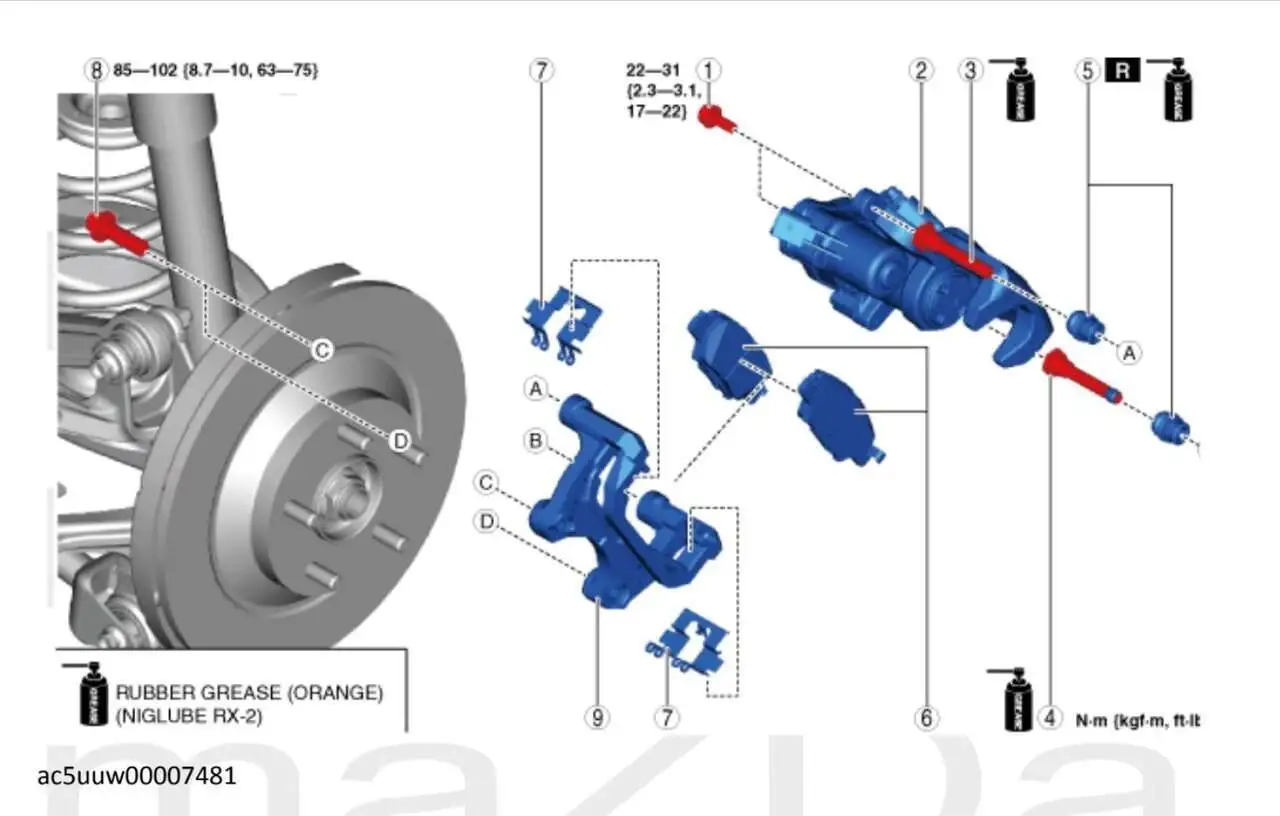

I am replacing the rear caliper and am taking off the Electronic parking motor on the rear brakes. Does anyone know the torque specs for these 2 bolts that attach to the caliper to mount the EPB motor..?
I talked to a technician at the Mazda dealership and he said the torque specs are 12 lbs for the 2 mounting bolts that hold the EPB motor onto the calliper itself.
