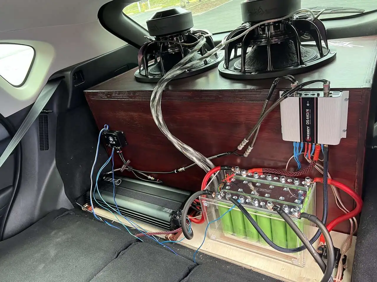

Has anyone tried bypassing the voltage regulator to charge at a constant 14.4V? Some cars it is as easy as unplugging the plug from the alternator...I'd like to try this myself, but I'm hesitating because I'm currently running a headway lithium bank in the back instead of a standard AGM battery and it can not take a charge over 14.8V without possibly becoming a back seat bomb lol. Pretty sure our max charge voltage is 14.4V but not sure if it COULD be higher with the plug unplugged...

Doing a big audio build, and running on lithium. A locked 14.4-14.8 charging voltage is preferred with the chemistry of lithium I’m running in place of standard car battery.

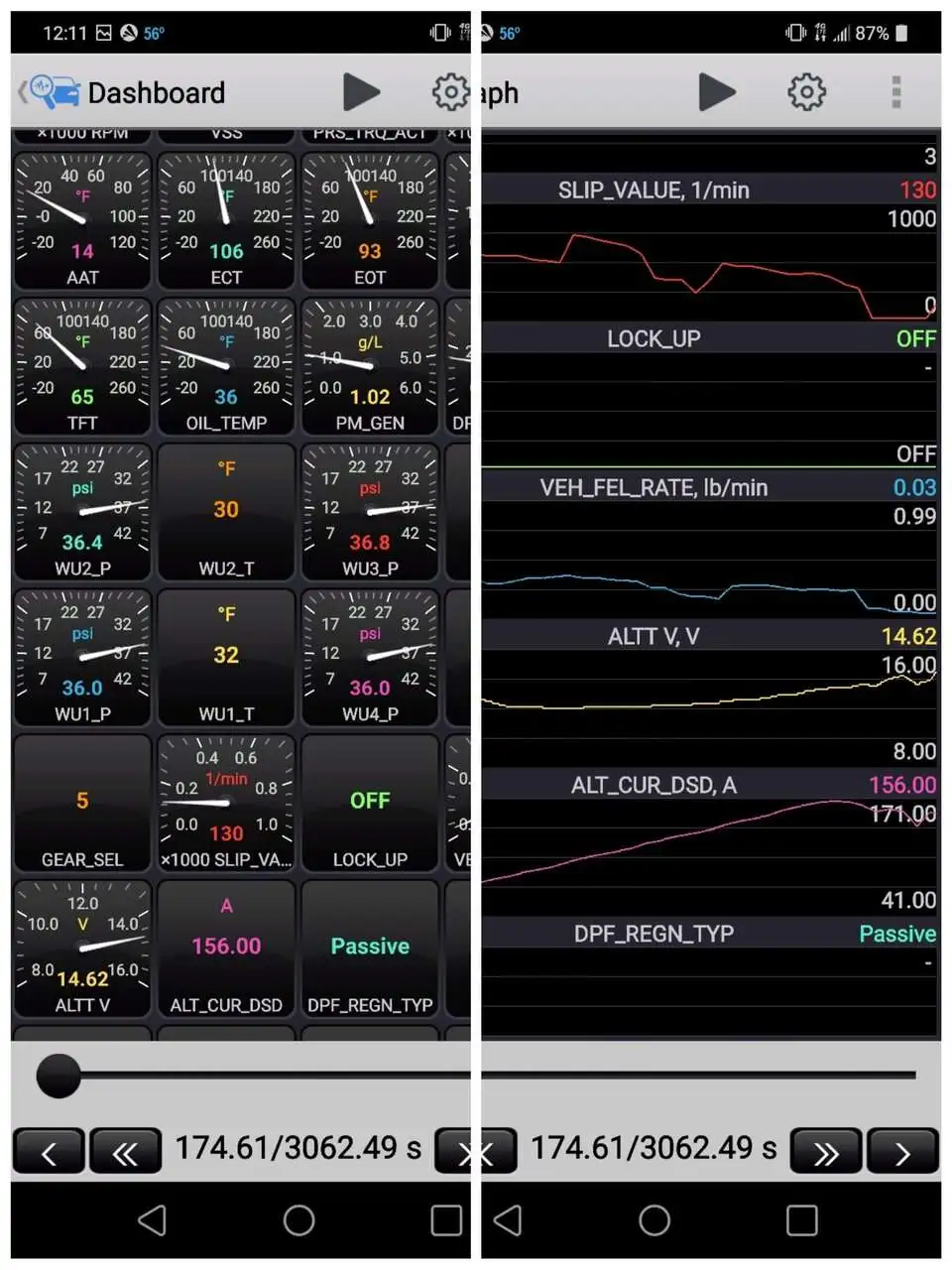

I use FORscan and show a pretty consistent 14.5 volts output from my alternator. It fluctuates some but not much and not for long.

Under load, my alternator is typically only charging to 13.6V, the amplifier I’m using creates best power over 14V. I’m currently dipping to 12.9V at heavy load, and our PCM controlled voltage regulator isn’t detecting that load and telling the alternator to produce full power. Most cars I’d be able to slap on a high output alternator and call it a day; but these cars have a lin bus that’s hard coded to the ECU and can’t be bypassed making it impossible. If I can’t provide more amperage with a HO alternator, my systems would benefit from a max continuous charge voltage. I know this will decrease alternator life, if I can go a year per alternator I’ll wind up spending the same as I would buying one HO Alt over the life of owning this vehicle. Removing the lead batteries and switching over to LIFEpo4 has been a major improvement on its ability to hold and recover voltage, but I’d love to see that recovery going into the 14s instead of mid 13s.
Huh, how bout that. I wonder what's different on your system. I scrolled through a recorded run and found a spot where my alternator was putting out as high as 156 amps. The voltage dropped to 13.88 as the power was ramping up but then settled back in and held at 14.62 volts.

Depicted is my (North American) 2019 Signature with the 2.2 diesel.
