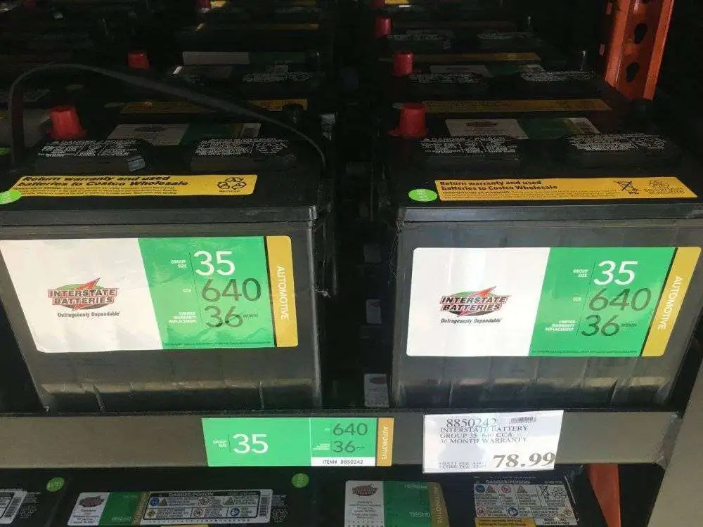

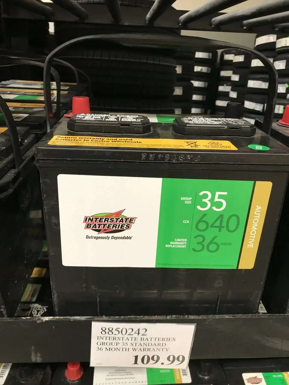

Here the popular (here) Group 35 Interstate battery at Costco used to be $78.99 for many years:
Now:
That’s 40% price increase in last 3 years!

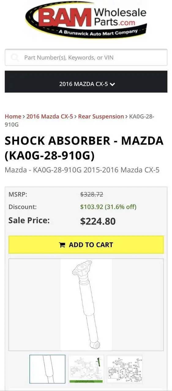

Just on the other day I found the OEM rear shock part no. KA0G-28-910G for my 2016 CX-5 AWD which used to be around $80 each now is selling for $224.80!!! 🤪

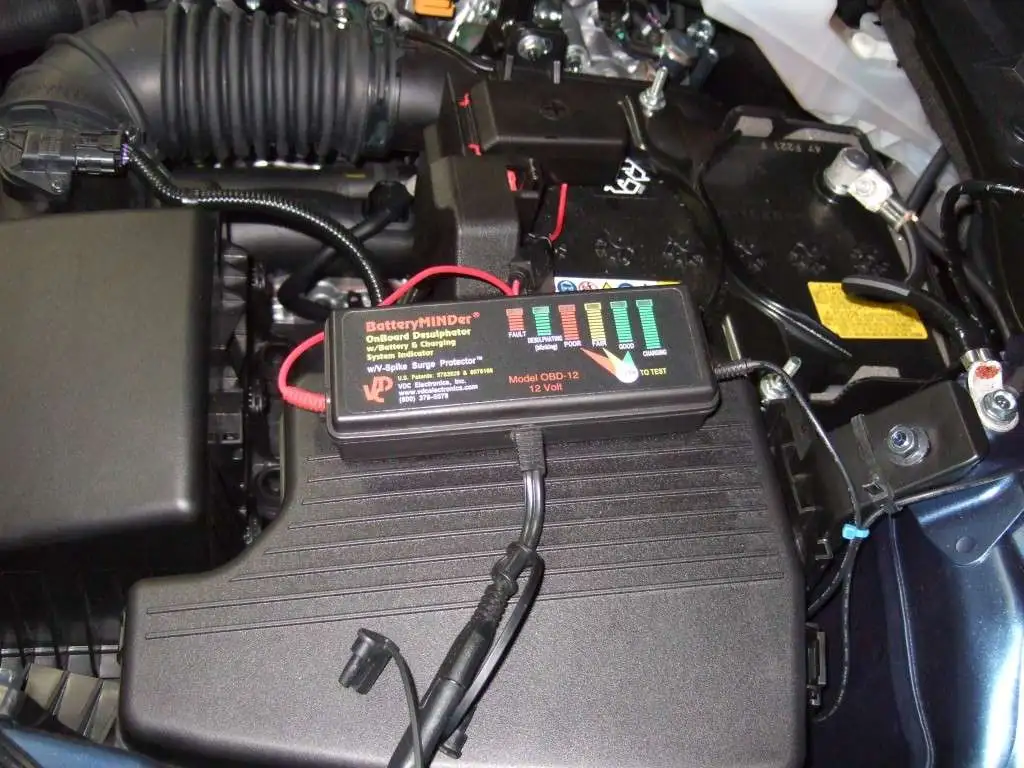

  1. Pick up a Batteryminder onboard Desulfator. It comes on when the battery is being charged by the altenator and keeps your battery in tip top shape. I've installed them in all my cars since around 2000 and they extend my battery life to avg of 9 years! I actually just installed one from my 2003 Maxima that the CX-5 replaced. I recently picked my last one up at RV shop for $82 delivered to the door. It was for my 2020 Ford Ranger. These things work!

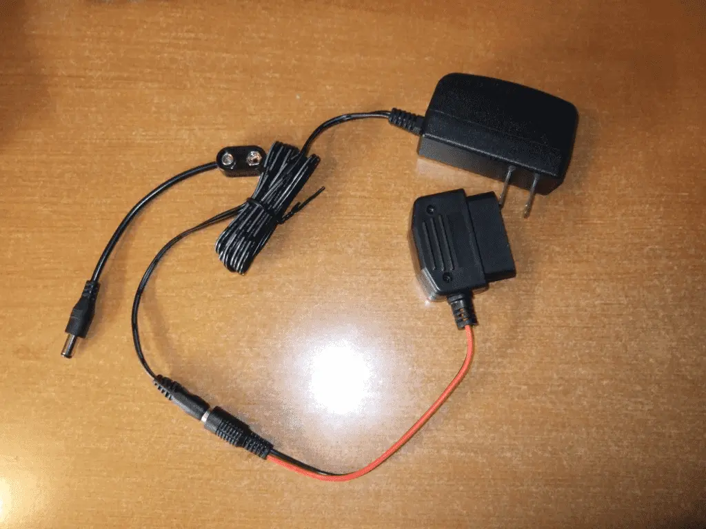

  2. The second item was purchased quite a while back when I bought my 2020 Ranger. It is a small 12 volt adapter that is designed to keep your auto's computer settings when changing batteries. You simply plug the device into you trucks Diagnostic port, and plug it into either a 9V battery (good for ~30 minutes with a new 9v battery), or a 110v wall outlet with a 12V wall wart PS. Then remove and replace your battery. This keeps power to your systems while you switch out your battery. I bought it on a whim, and thought I'd never need it. https://www.amazon.com/dp/ (commissions earned). A battery charger does essentially the same thing, but keeping the charger connected when removing cables seems a bit tricky to me.

I just read a bunch of articles on battery desulfaction and the devices appear to be the real deal and work. Interesting, never knew they existed.
I just read a bunch of articles on battery desulfation and the devices appear to be the real deal and work. Interesting, never knew they existed.
The Battery Minder is the best of the lot. Uses multiple high frequencies to break up the sulfur crystals and lower internal resistance. My batteries stay at around 3 mOhms. I just checked my new CX-5 battery (car 2 weeks off the lot) and it is at 5.5 mOhms! I am desulfating it right now, Will take at least 2 weeks to get it back to optimal shape, but then it is good to go just from driving the car normally. The desulfator starts doing its thing at just above 13V and stops when battery voltage drops to 13V. Pulls no drain at all when they stop. Simple to hook up to. Red to positive post, Black to neg post - Done!
The only battery that I have owned in the last 20 years that didn't make 9 years was an Optima in my 2005 Ranger that sacrificed itself when my alternator died on a road trip 150 miles from destination on Christmas Eve. The battery just barely got me to the destination where I had called ahead and had an Auto parts store waiting with the replacement. The truck dash looked like christmas tree lights to within 20 miles of the destination and then even the lights went off. The truck stumbled to the parts store, Pressing the brakes for more than a second would kill the engine enough to make me let off the brake pedal. I recharged the battery (it was 7+ years old) but it never came fully back... lasted another year, so it made it to 8+ years.
I have these desulfators on all 4 cars that I own. And the batteries typically go 9-10 years. They are worth every penny!
