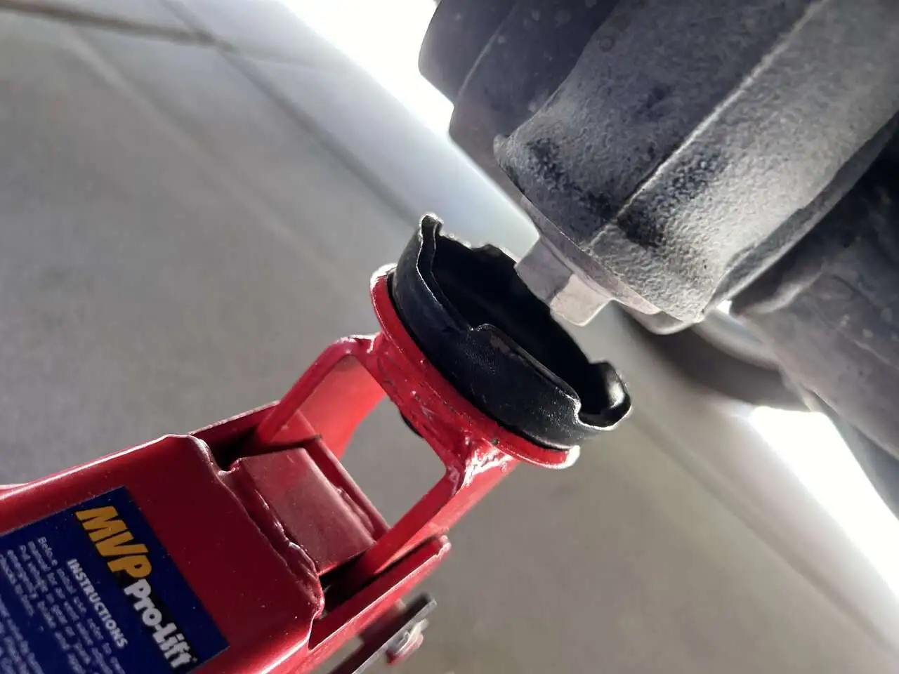

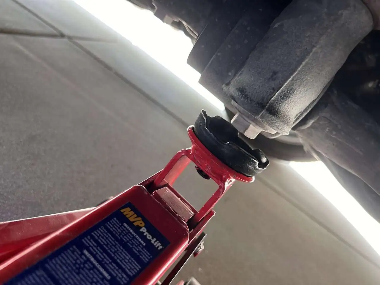

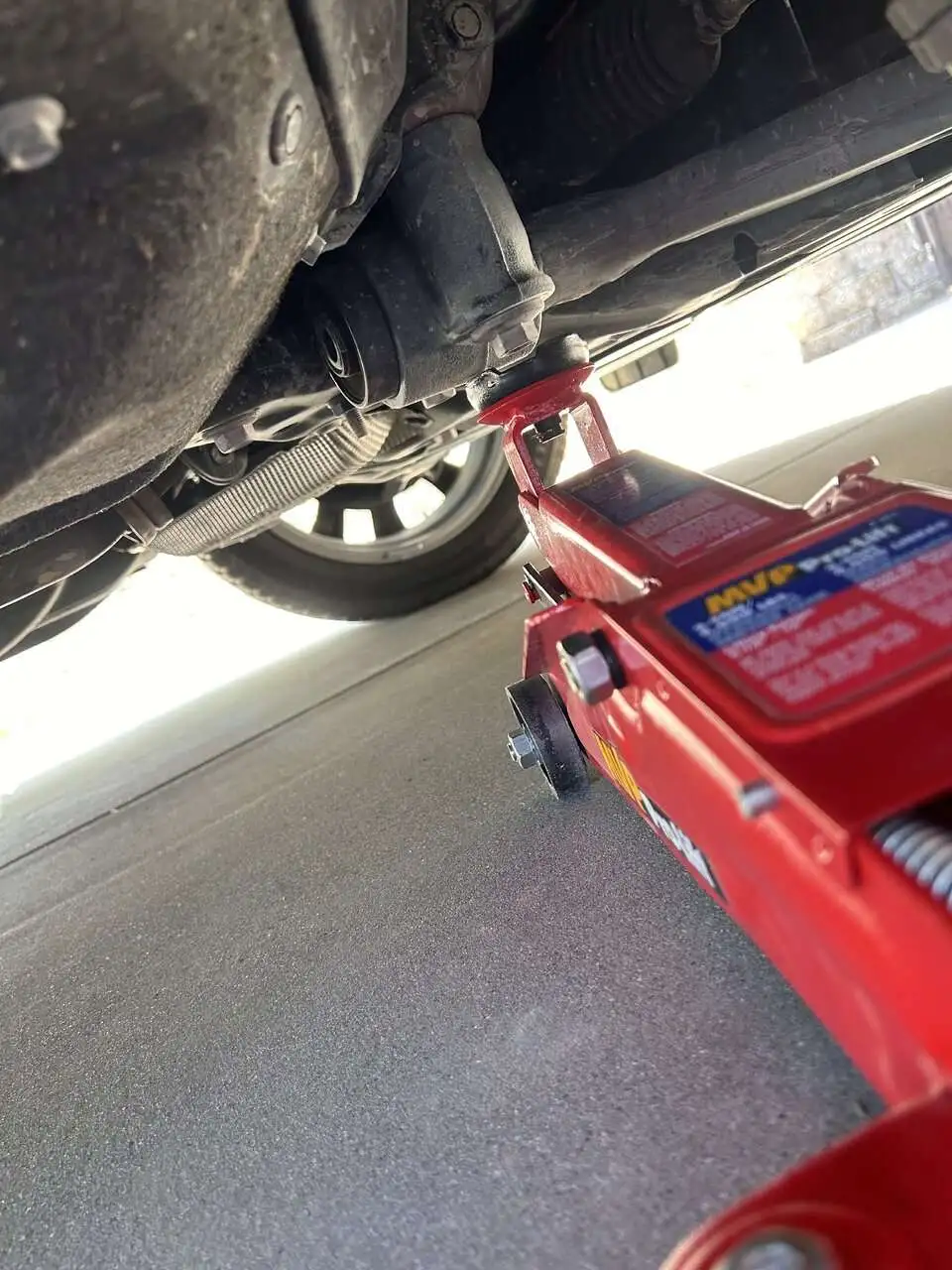

I can’t use my floor jack on the stock center front point (the dimpled metal plate) because there’s not enough space to pump the lever through the complete range of motion. I’m thinking of using this suspension points, see pictures. One side at a time: lift, jack stand at the pinch weld, repeat on opposite side. Any issues with this plan? Thanks!

Don't have an answer to your question but I personally wouldn't do it. Perhaps you can get a piece of 2x4 lumber as a "ramp" to give you that extra space to jack up from the stock location. Or maybe even a few pieces of paver stones?
I tried a couple of lumber pieces I use with my other car but that didn’t give me enough clearance. Maybe I’ll double up on those.
Your jack doesn't have to operate through the entire range of motion to work. If the handle pumps up the jack at all, just keep pumping till you get it jacked up. Once you get it up above a certain point, you'll be able to pump it in its full range.
