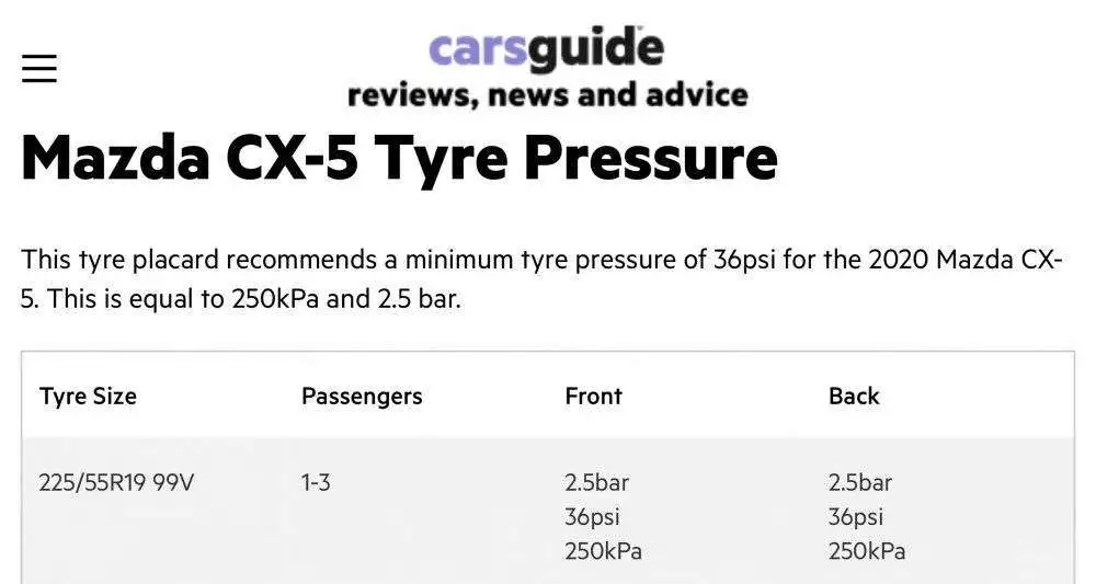

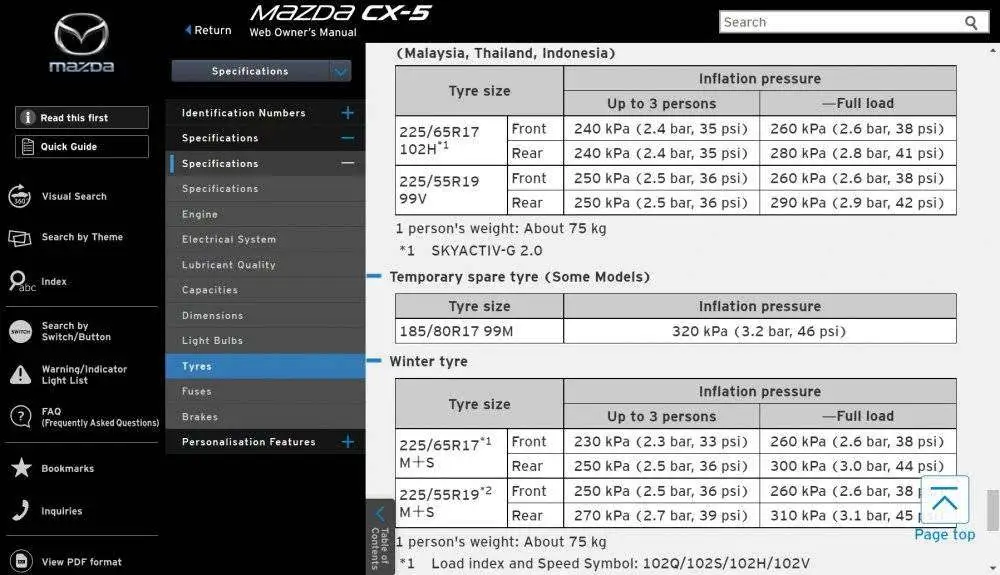

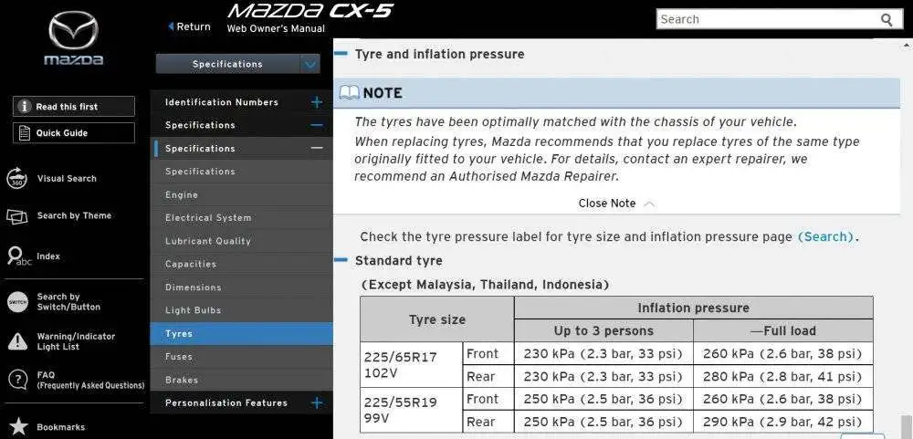

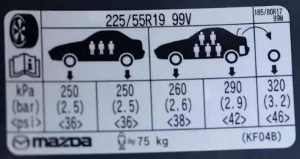

I’d put higher tire pressure than 35 psi which Mazda recommended in the US. You have full load, and putting 38 psi front and 42 psi rear would be what I do. Of course check the maximum tire pressure rating on the sidewall of your tires. Most likely it’s 51 psi. Here are tire pressure recommendations from EU Mazda CX-5 for your reference.
Nitto nomad grapplers 107T, so max psi is around 50 i believe
