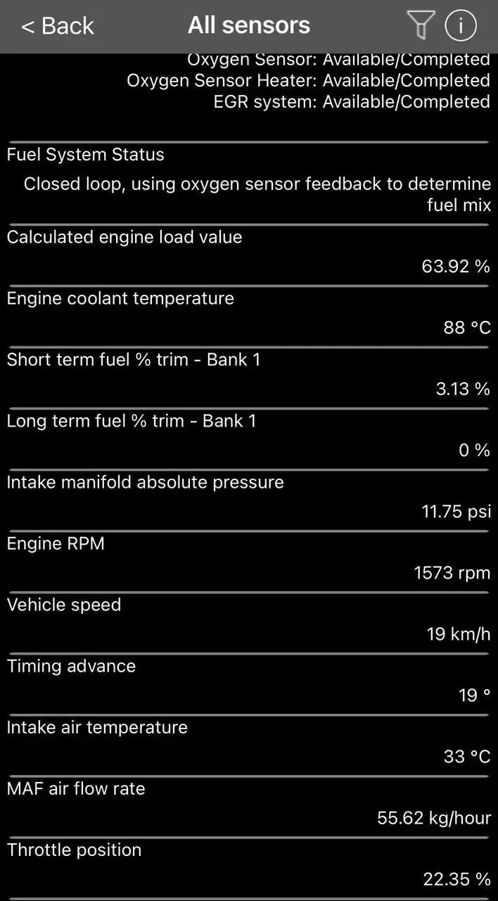

Thanks! The coolant temperature via OBD live data reader varies between 88 and 95°C.
Thanks! What would be the trigger setpoint? Above 100°C?
On my CX-5 the fan-on setpoint is 100°C, and it will shut off when ECT is back down to 91°C. Although your vehicle's engine is not the same as mine, I suspect the fan setpoints are either the same, or at least very close.
