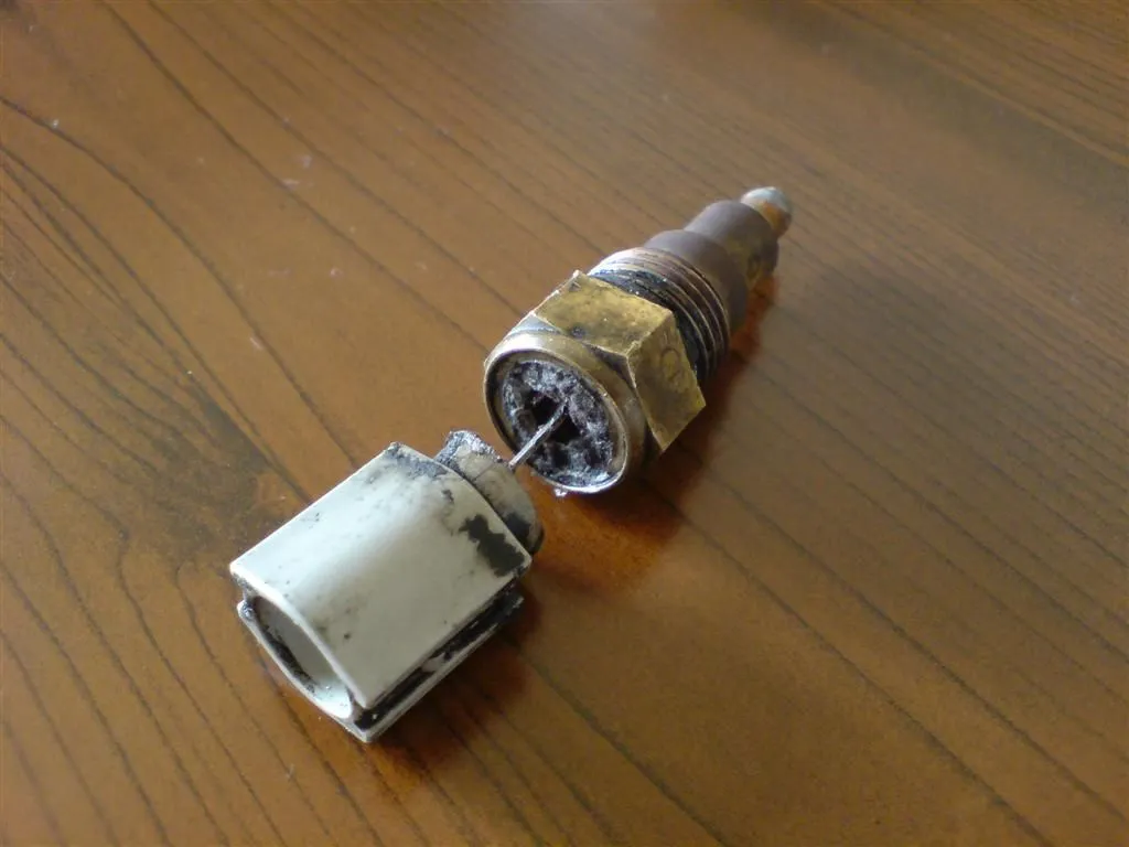

My mazda Protege 1990 suffer over heat last night in traffic and I notice that the radiador fan is not working, today I tested the cooling fan with direct 12 volts connection and it's working fine, now I need to know from where I should begin to search for the problem. Any help will appreciate.
Thanks, I found our a broken temperature sensor, I replace it and now it's working perfectly.:)
