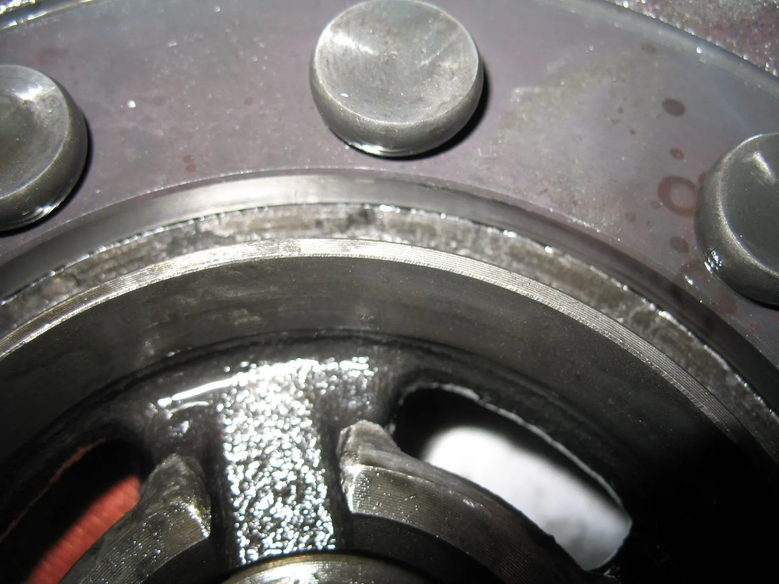

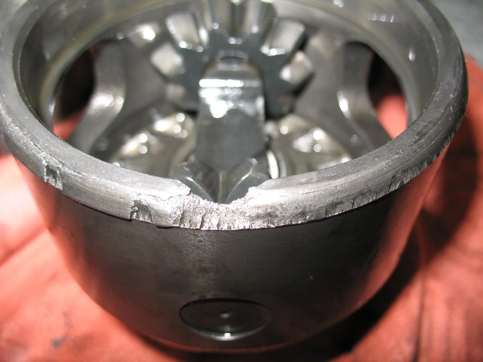

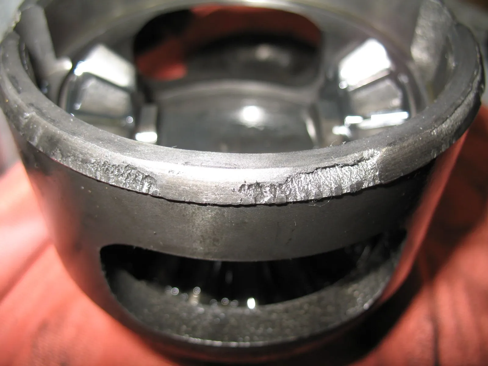

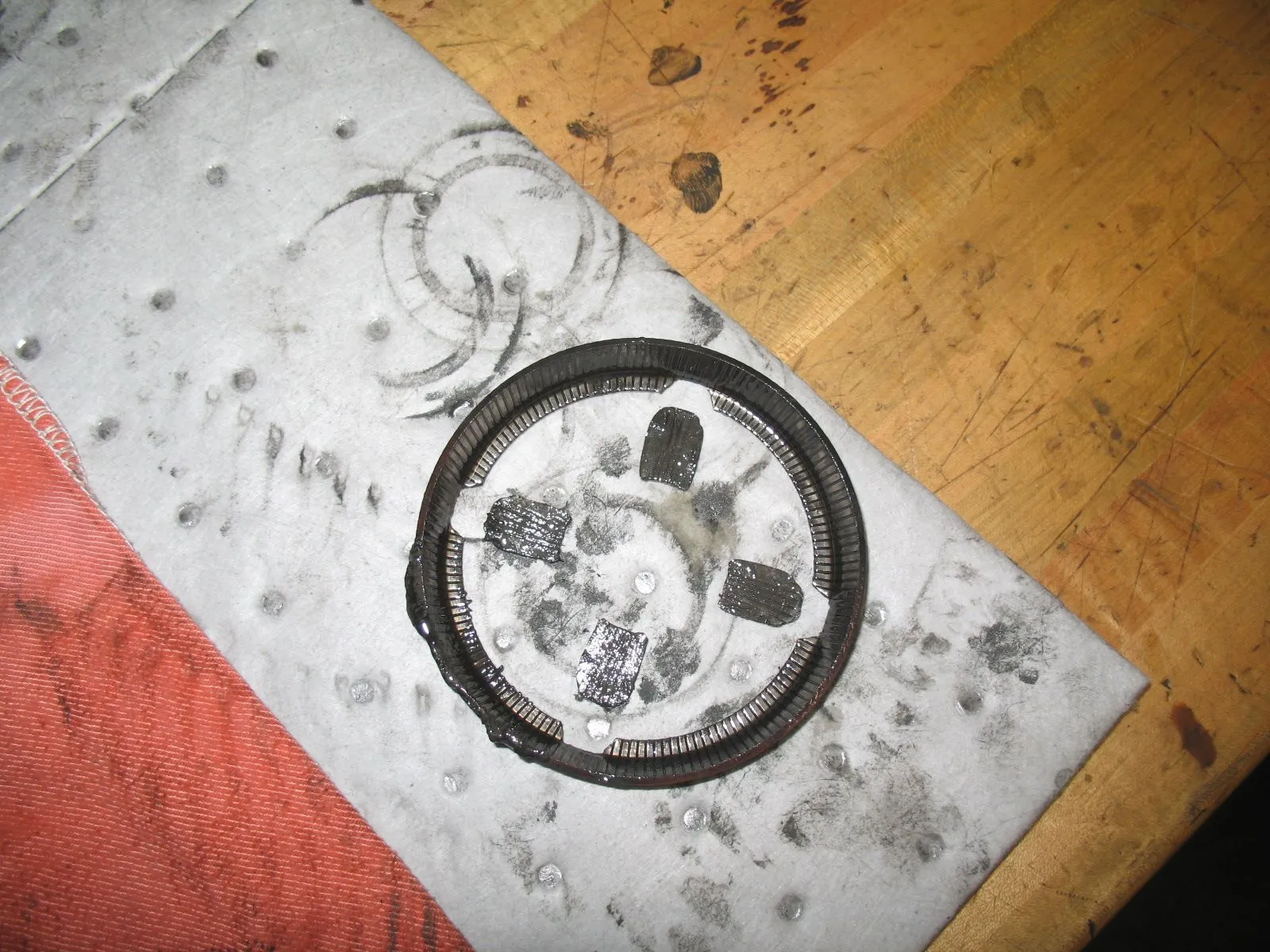

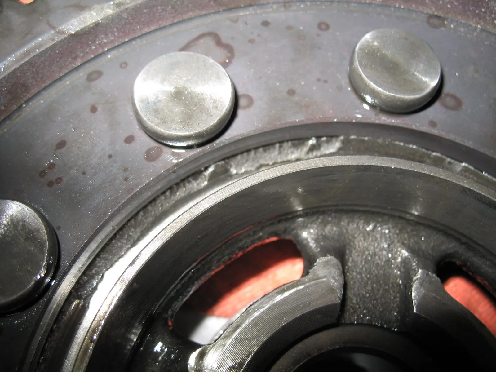

Friday i lost all drive under a load and figured clutch or lsd. Got it into work and got it apart. (pics to come once i get home from work) Guess last saturday's twisties was the last of it's glory!
So i was chatting with Steve a bit and he thought it was my lsd also. Finally got the trans apart today and confirmed it.
will post more once i find out if extended warranty covers it or not and then placing an order with the steve-o
here's the pics

ohhh my....u probably knew that was coming sooner than later though. Remember talking with you and you saying that the car has been great to you and you have been relatively problem free and most known problems had not yet happened. Then i remember a common phrase "Knock on wood" comment by you not followed by the actual action. too bad man but i know she will be back up and running soon.
$0 deductable service contract FTW!!!!
$1900 repair free!
ordered a new stage 1 exedy clutch to go in while it's apart from steve (cool)
to answer everybody 59k miles and its posted in the lsd failure list and i already have pictures for my tech to weld the new one once it's here
car should be back together sometime next week (headbang)
