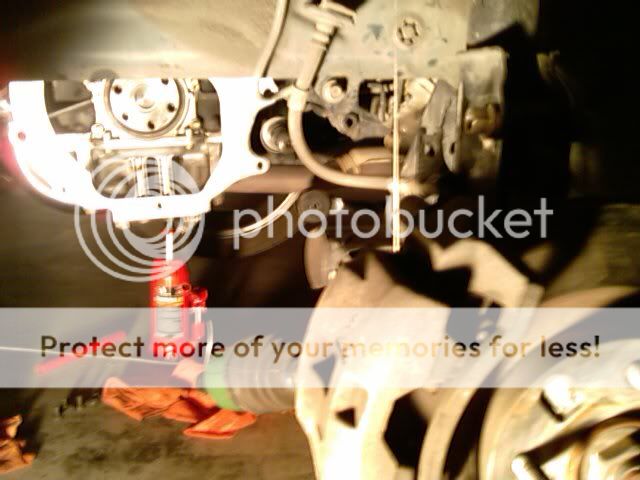

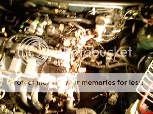

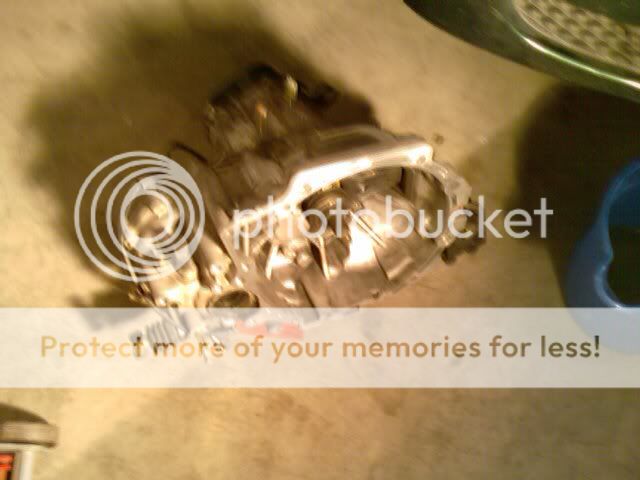

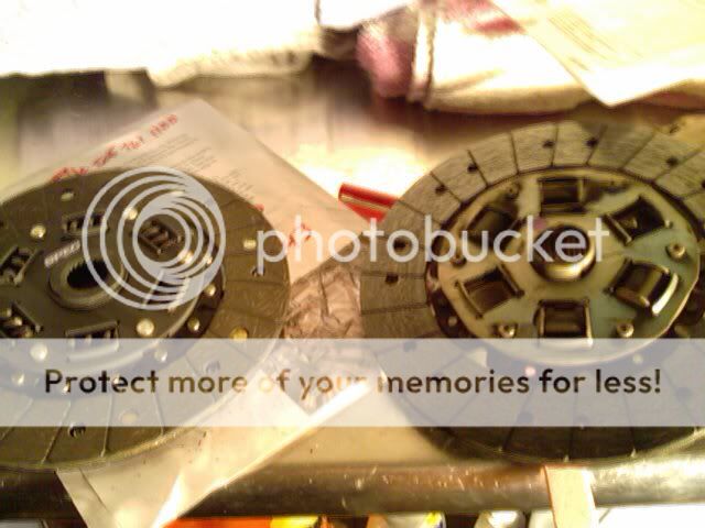

update: got half way through the project, if we would have had the parts i believe we could have finished it easily in one day. it took about 4 hours to the the transmission out with the help of that how to! that helped alot. it generally went really smooth only bump was disconnecting the drivers side transaxle out of the trans but a few tugs and working it around and it popped right out. so we got it out and brought the flywheel down the napa to get resurfaced then over to mazda to order the transaxle ds and ps oil seals. the ps one got trashed while trying to figure out how to get the transmission out. :/ not a problem that the car is up in the garage for a week though, i have surgery tomorrow and have to watch some friends finish it for me next weekend. thanks for your help!

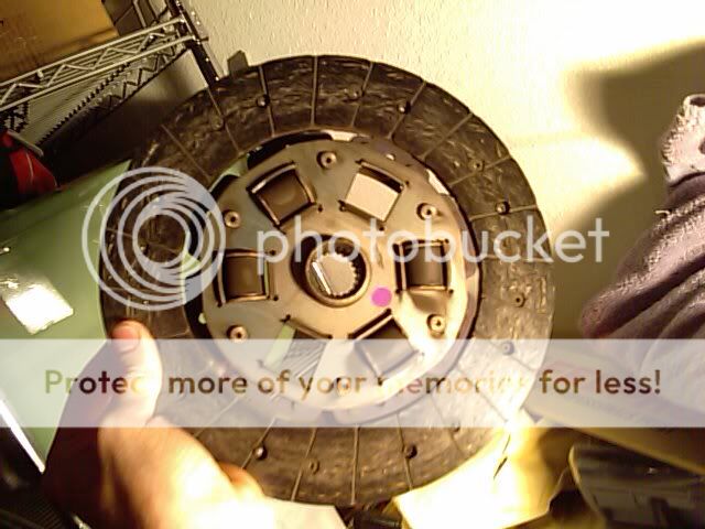

old clutch, are those 2 holes suppose to be there?
it was pretty straight forward to remove the transmission. just take your time and keep track of all hardware. a bottle jack and a peice of wood to hold up the engine is a must. if you go through with the project feel free to ask any questions, i will be glad to help you out in any way possible.
I have the transmission completely unbolted, everything i could find is let go, but the transmission will not come off the engine. Any tips to get it off? I gave up 4am!
