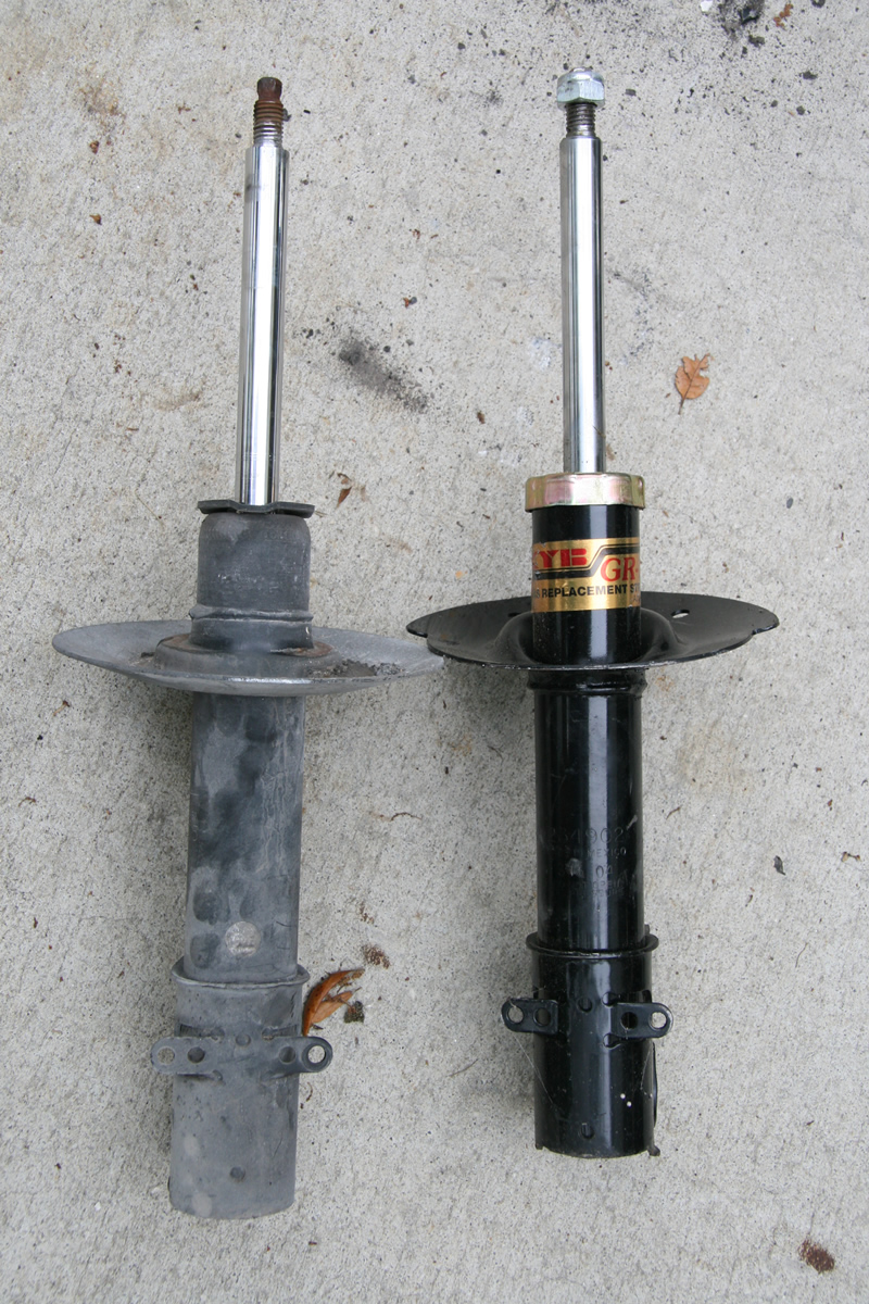

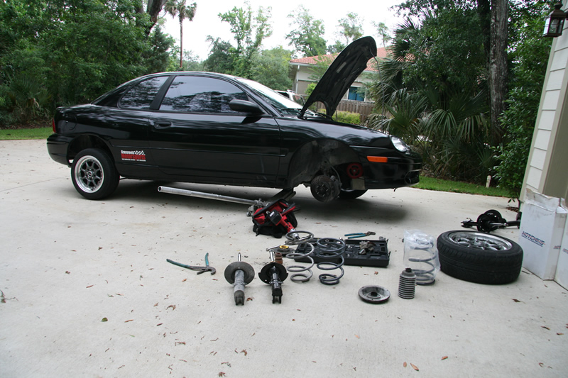

take the negative reviews of the kyb's with a grain of salt. grassroots motorsports magazine actually used the g2's to go rallycrossing in their 1996 dodge neon acr:
http://grassrootsmotorsports.com/project-cars/1996-dodge-neon-acr/

+1 blackmica_es
I have KYB G2s on my 02 Tundra truck. They are are a gas charged monotube design and are much better than the OEMs.
Grassroots Motorsports Mag is my monthly periodical. This is a great data source for tech tips, brakes, suspension, drivetrain and tire reviews for tracking and daily driving.
