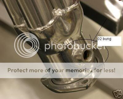

Ok after seeing the 4th person this month who has paid nearly $20 for a silly
02 bung, I've decided I'll share some much warranted info. For all of $3.59 and a drill you can get TWO o2 bungs!!! Simply go down to your local autozone/discount and stroll on down to the HELP section. Grab a set of the antifoulers(there are 2 types make sure to grab the standard thread ones) and proceed to your garage/shop/kitchen table... I use a drill press for the next part, which makes it supremely easy, but a hand drill will work also. There are 2 steps left. First you'll want to use a 1/2" bit to drill out the center hole on the antifouler, THEN you'll use a hacksaw/bandsaw/etct to cut off the end as needed for length...for 95% of applications you will slice it off at the "step"...I do the cutting second b/c it fits perfectly in the hole i have on the baseplace of my drill press, but I suppose you could cut first then drill. Then just weld it in and go take your girl to bennigans with the extra money you saved! Its a fairly simply process, but if needed I suppose I could make a how-to with pics and whatnot in the next few weeks...

What is an O2 bung and what does it do?
O2 bung is were your 02 sensors screw into on your exhaust. DSMConvert is telling people were to get them so they can either run their sensors on a custom exhaust or also add an extra bung for a wideband. Some places carry them cheap, others dont.
