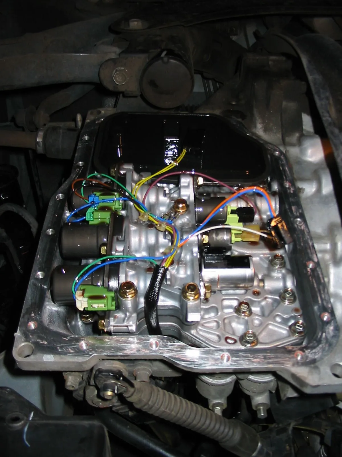

Removed the driver's side belly cover and dropped the trans pan and there were ALL the solenoids staring at me and easily serviceable -- without dropping the valve body! One 10mm bolt secures the EPC solenoid onto the solenoid assembly of the valve body. It is sealed in the valvebody with a small o-ring (comes with solenoid).

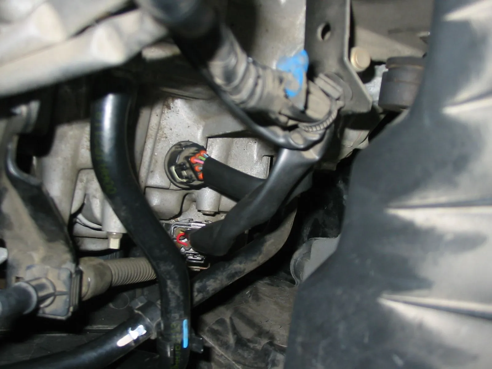

I OHM'd the solenoid directly on the vehicle and it read DEAD OPEN between both terminal A & B; the ATX case wiring harness (9-pin) terminals (D & I) already confirmed this reading before I started anything.
Remove 10mm bolt and wiring harness. Then carefully pulled out solenoid horizontally; you will get some resistance from the o-ring seal... just pull smartly and be careful of sharp parts!
Install the new solenoid by lubricating the o-ring with new ATX fluid and follow the above-stated directions in reverse. Push in solenoid gently and it should snap in place on the valvebody. I tested the new solenoid and it passed with a reading of 4.4 OHMS (normal = 2.4-7.2).

FYI: The EPC solenoid is the first one on the right side of pic (bright silver); front of vehicle is the bottom of pic.
