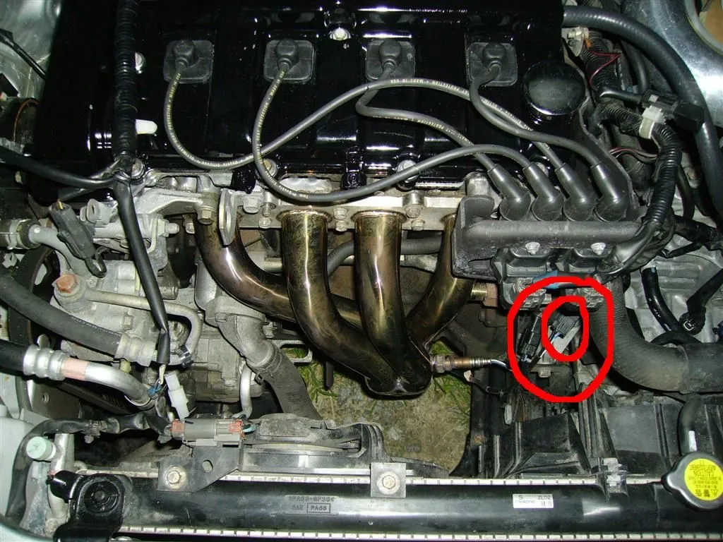

i just had the same code ran on my speed, I put the vibrant on and i think the jackass who installed it put the 2nd o2 sensor in front of the Cat. If i relocate that o2 sensor behind the Cat will that remedy the code? Sorry for a thread jack.
The sensors are the same, so it wouldn't matter which you put where, however the two sensors have very different cable legnths, the one closest to the EGR pipe has about 1/2 the cable legnth of the one past the cat, if he damaged or lost the one that's closest to the EGR pipe, it'll be pretty noticable that there's *alot* of slack in the cable for the one that's installed closest to the EGR pipe, which of course would set off the code since there's no sensor to read off of . Now, if he just forgot to plug in one of the sensors to the plugs just below the EGR pipe thats different. If you look at the picture I attached, the first red circle shows where the two plugs are for the O2 sensors, and the second red circle is the plug for the O2 sensor in front of the cat(that is the cause of the code)

Thanks for your reply, i have an MSP so, the vibrant bolts up to the Jpipe on the turbo. The first sensor should not have been effected at all by this.It also removes one cat (if my memory serves me correctly) The second O2 sensor though should be installed behind the cat (i believe) That is what i believe to be throwing the code. Any further informations on this will be greatly appreciated. If my assumptions are correct or not im not 100% sure. Thanks again
210_ZOOM, once you remove 1 cat, you'll throw a CEL. you need to use an MIL eliminator, or even better, use the non-fouler method
you *could* put the damn stock exhaust manifold back on, drive to the dealer and get a new cat for FREE and then put your 'shorty header' back on you know

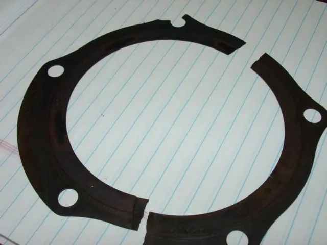

I have this code. Last night I removed the catalytic converter and discovered that the dual layer metal gasket that is between the ex manifold and cat is broken. It is actually broken through both metal sheets in 2 places and is starting to crack apart in a 3rd place.
There was a post somewhere here that showed a MAZDA troubleshooting sheet for this error code. I believe the 3 suspect causes were
Oxygen Sensor
Catalytic Converter
Exhaust leak.
MY QUESTION TO THE FORUM IS
Should I just replace the gasket hoping it is an exhaust leak and see if the code goes out? Or go ahead and replace the whole cat as well and get it done with?
I do not want to use the CEL eliminator for many reasons.
When I shake the cat it doesn't rattle or anything, but could be "poisoned"
I don't see exhaust carbon on the manifold shield or anything else suggesting a leak (would I if there was???)
