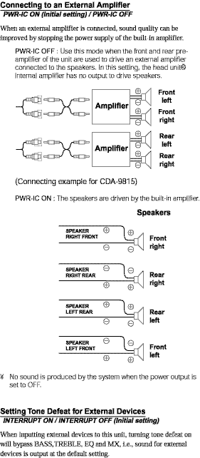

Now that I have my external amp I read on the head unit book that if I turn off the Head Unit Build amp the quality of the music will improve.
Can some one tell me how to turn off the build in amp of my head unit CDA 9815 by Alpine?
Thanks
Alex

here is what the book says:

Press and hold the 'F' button to get in to the setup menu, you'll notice it says setup just above the 'F' button. Once in to the menu just use the tunign buttons to toggle through the settings, once you get to the setting which says 'PWR-IC ON' toggle it to the OFF position using the 'Band' button and you are done, you're internal amp will be shut down. This is also how you work all of the different menus, including the 5-band EQ, with the tuning, band and volume buttons.
The intructions are in the manual, you're just looking at the wrong section, but this should help out. :)

page 23, I was looking on that "F" button last night :(
thanks again Greg S
