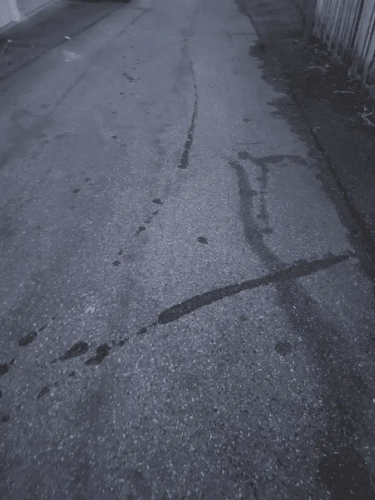

I did drive around my block to feel the symptoms, and when I came back, I realized a lot of oil was in the back lane.
I lift the car and look underneath and realized that was coming from the transmission...

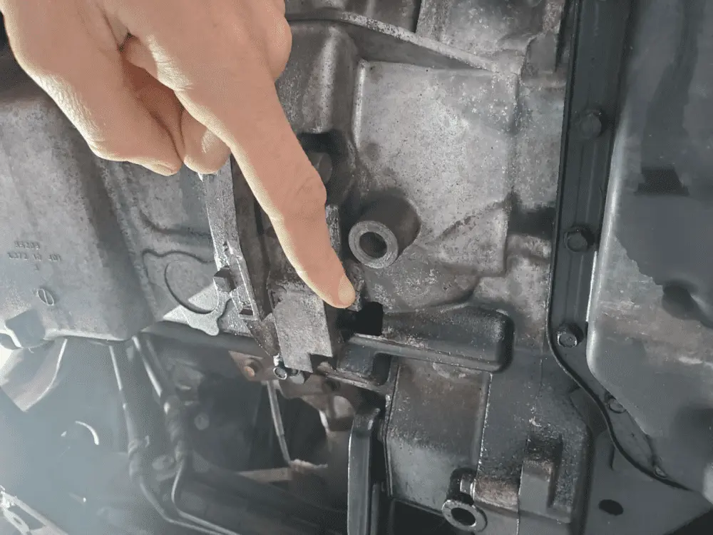

So I did a bit of progress today, I jacked up the car and started. No leak in Neutral but in Drive it's leaking a lot and I heard a big "clunk" noise when I shifted from neutral to drive.
I showed on the picture where the leaks is coming from.

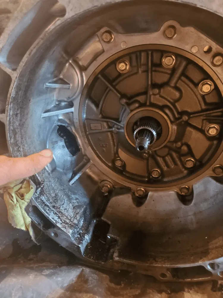

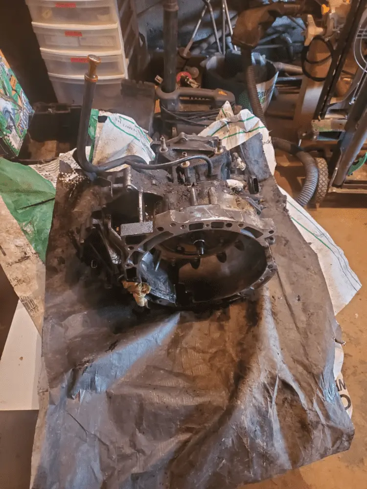

So I've made some good progress today, removing the transmission and looked at it.
There is a big hole in the case just above the CV Axles....
Its pretty crazy, I don't know how this happened...
Do you think it is fixable? I guess I will have to open it, change the case, but I don't know how far I will have to go to clean from all the small broken pieces. I never opened a transmission...

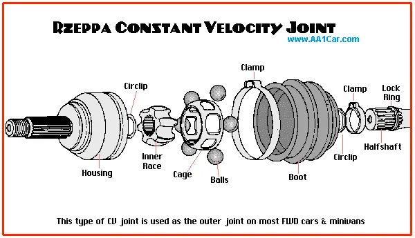

Update: The CV axle was actually the issue, it has play and so with the vibration it damaged the transmission housing...
Wow! That's wild. Did the lock ring fail? It is pretty rare to see a CV joint go catastrophic like that without a torn boot letting dirt and debris into the Cage. Usually flings grease all over the car when the boot fails too. Sounds like you'll need a Trans and a new CV Axle. The other side could also be damaged.
