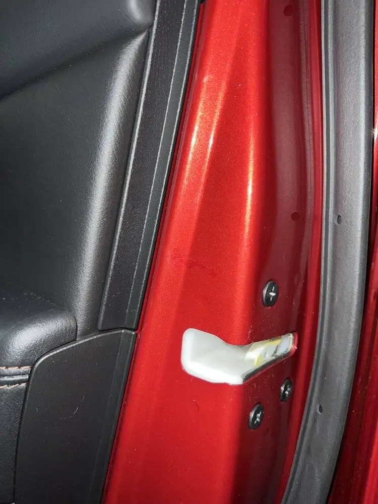

So I gave a friend a ride today, and when he shut the door he didn't check if the seat belt was fully retracted -- so it got stuck between the door and the frame. He didn't see it coming -- and neither did I.
My question is whether a touch up pen will fix this or will I have to get it fixed at a shop?

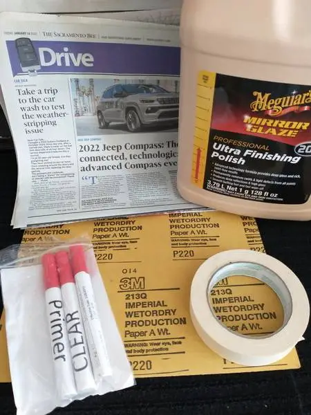

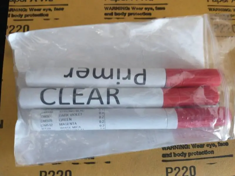

It is a touch up PEN set. Not just a paint PEN like most are talking about. The set comes with 3 PENs one is primer to fill the scratch, the next is the actual PAINT and the third is a clear. This is soooo easy to use. The only thing you need is a sheet each of wet sandpaper 220 ,1000,2000, some masking tape, old newspapers and car polish to finish it up. Its so simple and will only take a couple hours depending on drying time of each step.
A single paint pen on that scratch in your jam is going to look like a bad fingernail painting. HA!
One last thing if you use a "PAINT PEN" and you don't like the results it will be more work to correct that. You would need to sand out that paint first before trying another attempt to repair the scratch.
There are a few places that offer the Paint PEN set/kit that I have been referring to.
This would be the ideal solution but one, it was too late when I saw this message, and two it's unfortunately too cold outside for me to work on the car for a couple of hours. I had sent the dealership an email with the photo asking for suggestions, they called me today and said I can use a paint pen. The pen has two ends with "Top Coat" and "Base Coat", and I was done in around an hour.
This is FAR from perfect, but I think it's good enough. I'm rarely the passenger in my car, and I'll forget about it in a while. At least it won't rust.
