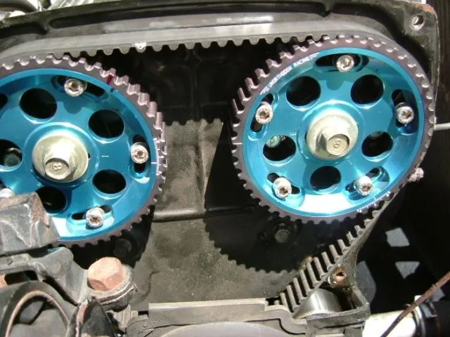

Also what are cam gears? Are they on the end of the cam connected to the timing belt? What are the benefits of adjustable cam gears? How are the adjustable?

A cam gear can adjust the cam timing or phasing independently of the timing belt. It cam make the valves lift sooner or later than stock. Generally, but not always, retarding cam timing moves the powerband up, and advancing it moves the powerband down. Because horsepower is a factor of RPM, moving the powerband up, increases the AMOUNT of power. ie 100lb-ft at 4500RPM is about 86hp. But that same 100lb-ft at 5000RPM is good for 95hp.
HP=torqueRPM5252
