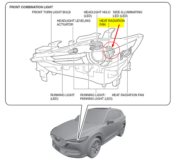

Most of the PDFs carry an individual wiring diagram but I would urge care with them. Firstly, mine are European PDFs and there are regional differences to conform to legislation. Secondly, the lighting is primarily controlled by the front and rear body control modules and I wouldn't know how they might react to having modifications made. For instance, I know you can destroy the rear body control module by changing the trunk light bulb while lit - it spikes the PCB. My CX-5 has the ALH headlights which have 24 individual leds for main beam but unless you tell me otherwise, I'm attaching the standard lights.
hmmmm...... interesting,
I'm surprised Mazda went with an active cooling fan for the LED's , I would have thought they would have gone the heatsink passive convection cooling (no fan) route.
Most of those tiny fans don't last more than 4 years before they fail or just stop running.
Well you're looking at $1500 for an ALH headlight and as far as I know, there are no serviceable parts inside.
