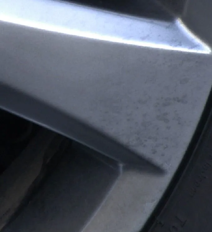

I was looking at my daughters new CX-9 (2 weeks old).
There are black marks in irregular patterns on all the 20" wheels.
Used some wax/cleaner but they appears to be under the clear coat. Told her to go down to the dealer and ask for new wheels.
Anyone else have this marks?

Yes, I have the marks, too. Reported my finding last week, 4 new rims are on order.
Is this caused by brake dust somehow affecting the clearcoat or somehow getting underneath it?
The reason I'm curious is that I've noticed the brake dust on my wheels and have cleaned it off every so often, but haven't really paid attention to look for the marks shown in OMF's picture. I'm wondering if this is something I have to keep track of.

I've found sometimes a wee tad spot of carburetor cleaner will take off stuff like that and not hurt the clear coat. Spot remove works too, just make sure you do it, then wipe it clean.
Of course, if the spots are etched into the clear coat, that's another story.
"Of course, if the spots are etched into the clear coat, that's another story." - And they are. No cleaner can remove them, not even professional cleaner solutions... That's why my dealer decided to replace them.
Dealer tried 7 cleaners and finally came to the conclusion that the marks are under the clear coat.
They contacted Mazda and ordered new wheels.
I noticed the same thing on my wheels.. I have the GT AWD with 20" wheels. Other than ordering new ones what else can be done? Did the dealer fight you on the replacement?

Scheduled for wheel replacement today.
Went to the dealer and left the car. They called and said the wheels that came in were 18'sm and wanted me to leave the car overnight until the new ones came in. No way!!!!
They took new wheels and triers off an in stock CX-9 and installed on mine.
They look good ...........and new tires............

Well, guess what? I have to retract my previous statement. After washing it today for the first time I inspected closely and now see that I have some of these marks along with what appears to be paint runs under the clearcoat of each wheel. Also, I have the left drift on any road surface that I drive above 50mph. To the dealer tomarrow.
