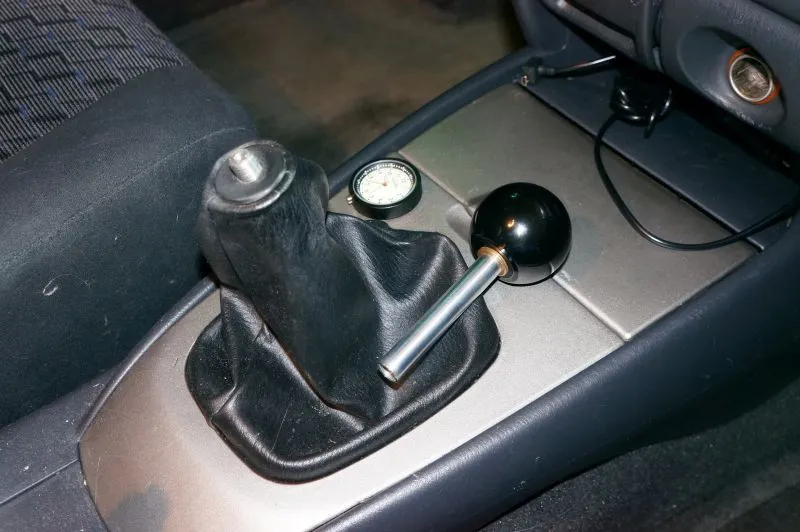

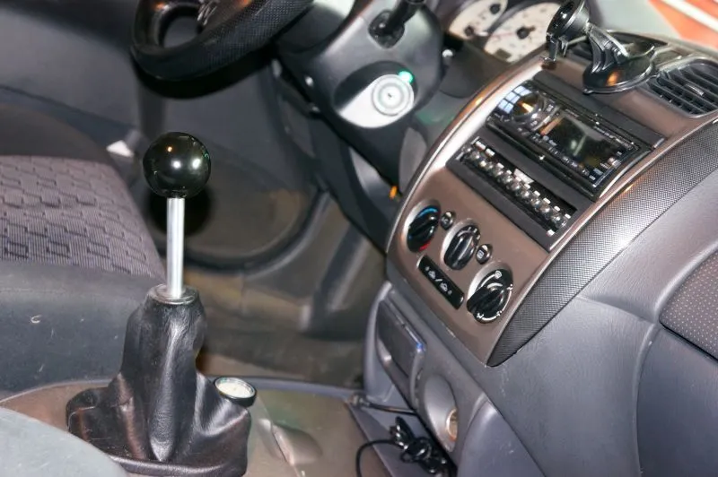

Not a huge fan of the old poolball style shift knobsView attachment 211146View attachment 211147
Doesn't anyone use a simple round black ball anymore? lolz. I do and I like it. I hope the jpgs show up. My goal was not necessarily to change knobs, but rather increase the height of the shift ball and still retain the oem "throw distance" or shorten it a bit. This was accomplished with the installation of a generic short shifter (cut off the top threaded portion of short shifter and cap it with the top from the oem shifter. The oem is a 2 piece you know. You set the angle to your preference before the JB weld sets up. And then you screw on your 3" extension and your favorite knob.
I realize I may have provide TMI. but I do it because it's information and many people are here seeking it.
