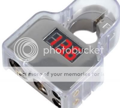

This would be awsome, only $22, there's a matching one for negative at $12
http://www.wiringproducts.com/contents/en-us/d525.html
Or you could use a 4ga from battery into this with all the 6ga going into the other side.

If you don't daisy chain, you will have 4-6 (depending how many u run) 4-6 ga wires going back to a terminal made to receive 2 or 3 0-4 ga wires.... Unless you get a bigger distribution block and not just a nicer battery terminal, you have to daisy chain. You really don't have a choice, unless you use 10ga wire and/or do a crap job shoving a bunch of smaller wires into a terminal designed for one bigger wire, which sorta defeats the purpose of having a clean grounding location.
I would use 6ga wire for the ground wires and bring those back into 2 main lines which would go into the battery terminal. I would definately buy an upgraded battery terminal that can at least take 2 2 ga. wires.

3 6ga wires would fit in a 2ga connector like the last picture (educated guess)...
