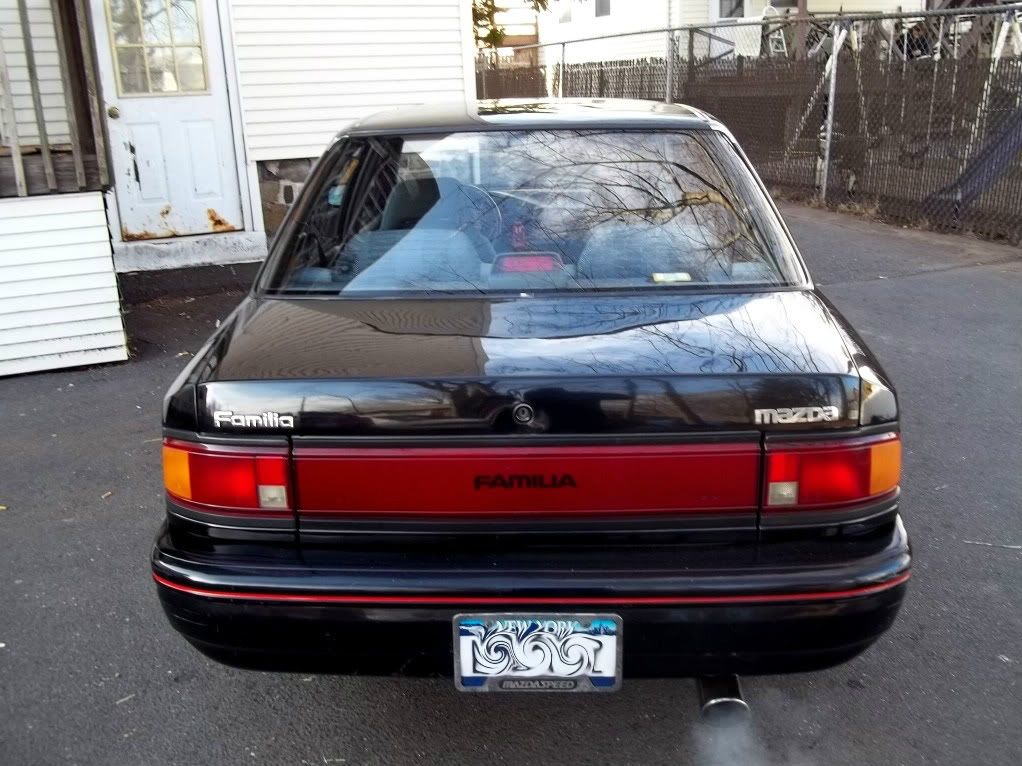

Familia Tails
Familia Rear Garnish with Rear fogs
90 Protege tail lights to match the garnish

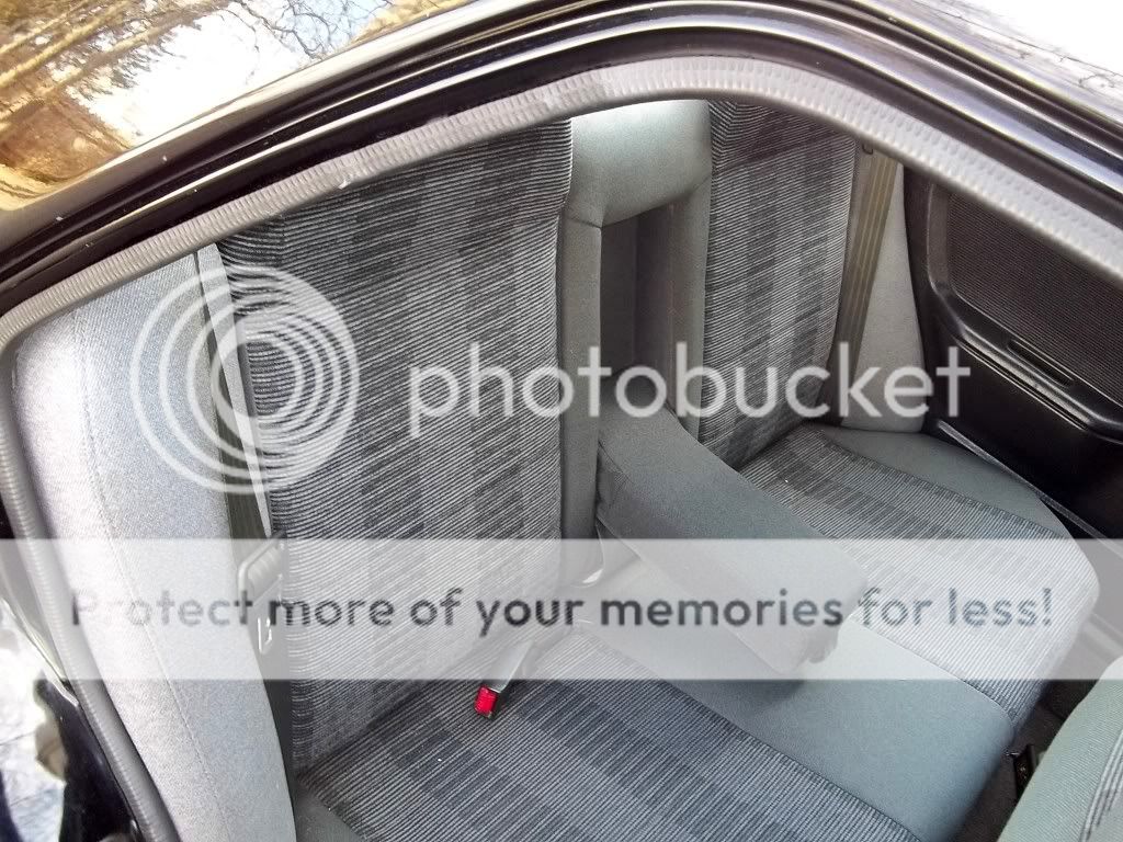

JDM Familia seats Front and rear

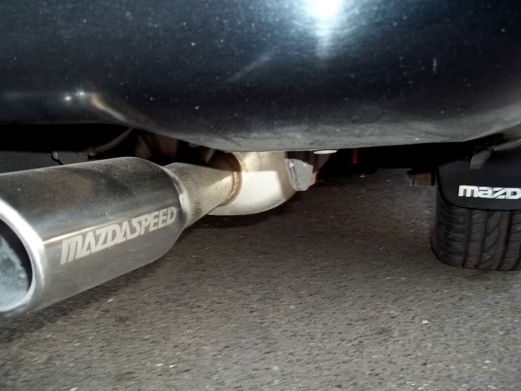

Mazdaspeed Protege RacingBeat Muffler

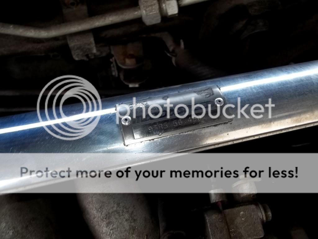

Mazdaspeed front strut bar

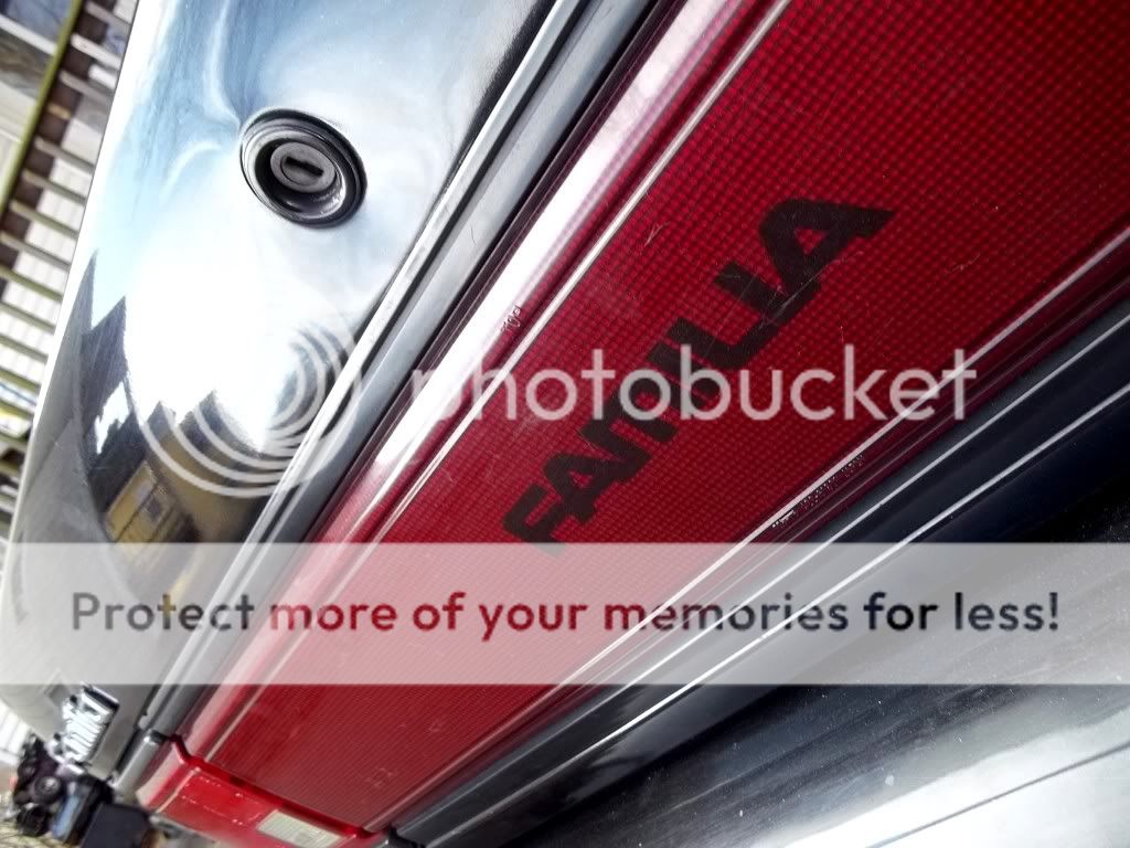

Rear Fog Garnish lit up::

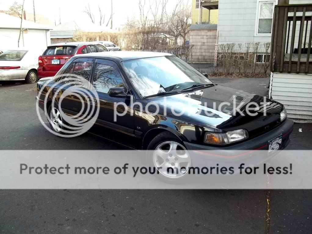

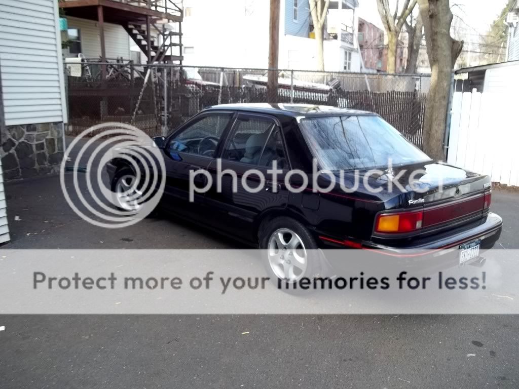

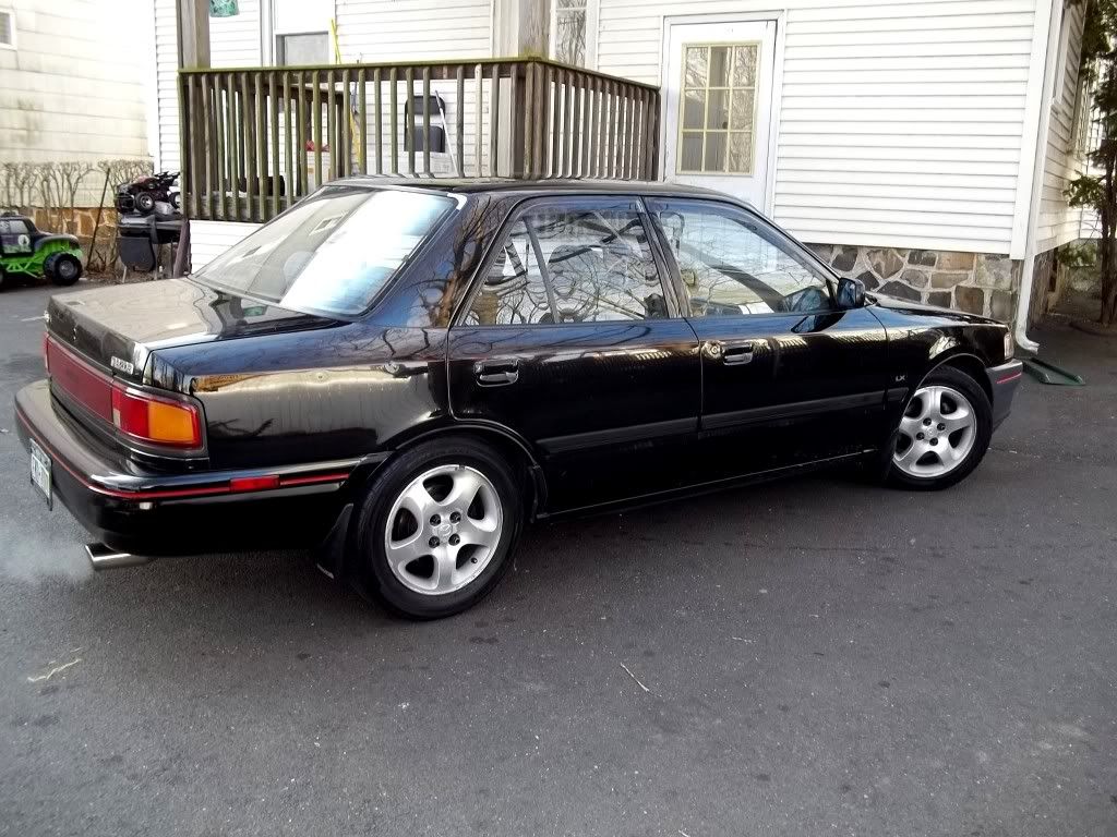

The car::
Mazdaspeed Muffler::

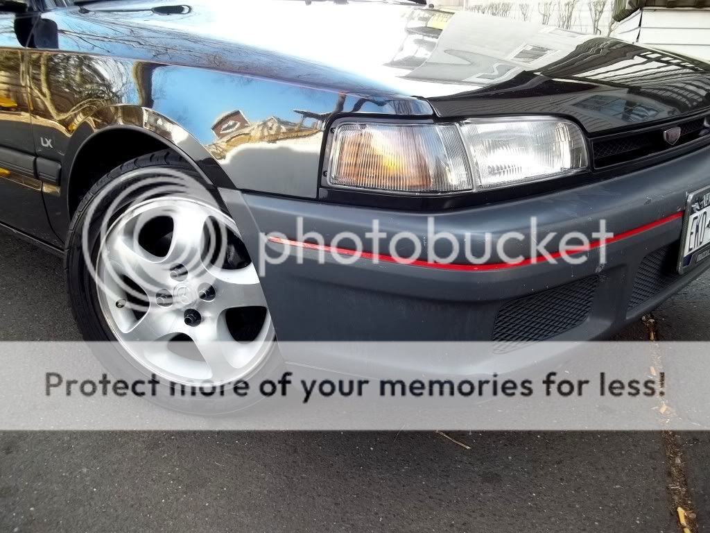

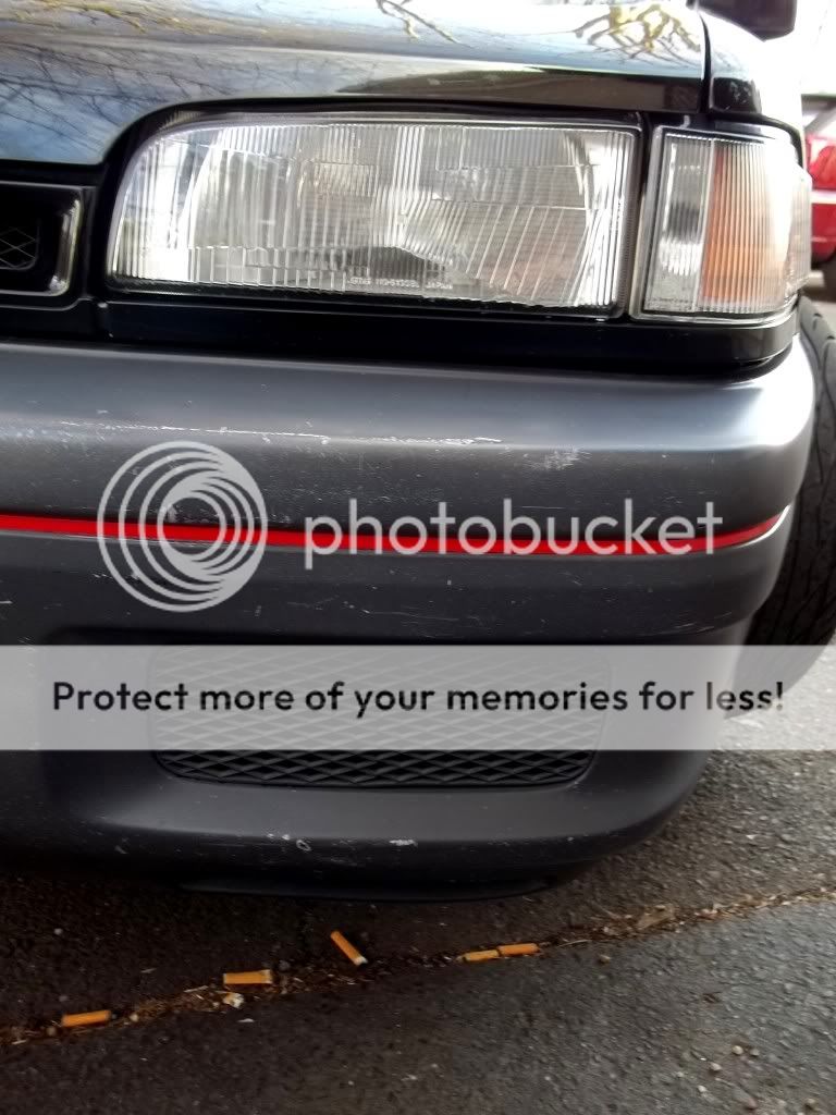

Infini Corners, 3 Hole, EDM glass headlights, Familia Grille::

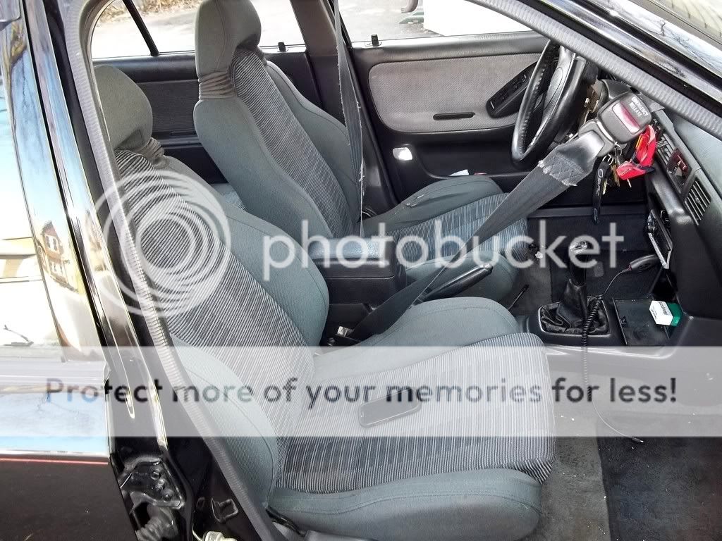

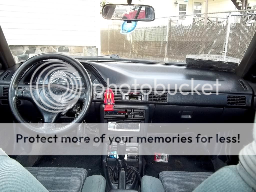

Interior:: (Added a Short Throw and Integra GSR Shift knob.. (I love how those knobs feel)

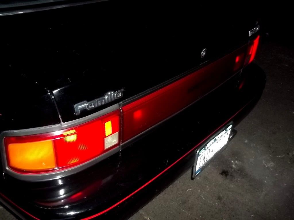

Rear Garnish:

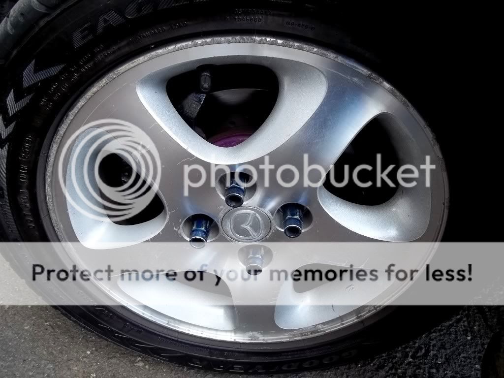

I added Blox Extended Lug nuts that I had laying around

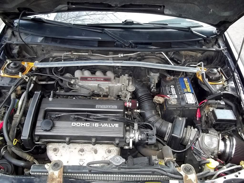

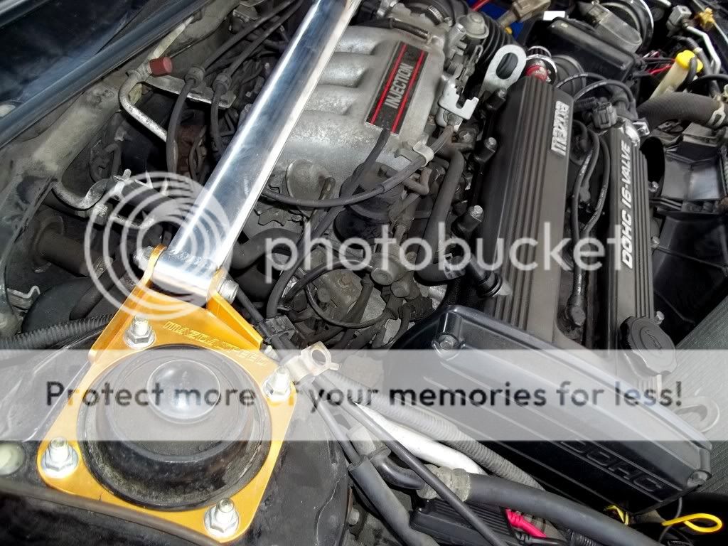

Engine bay, Dirty but clean, Mazdaspeed Strut bar::

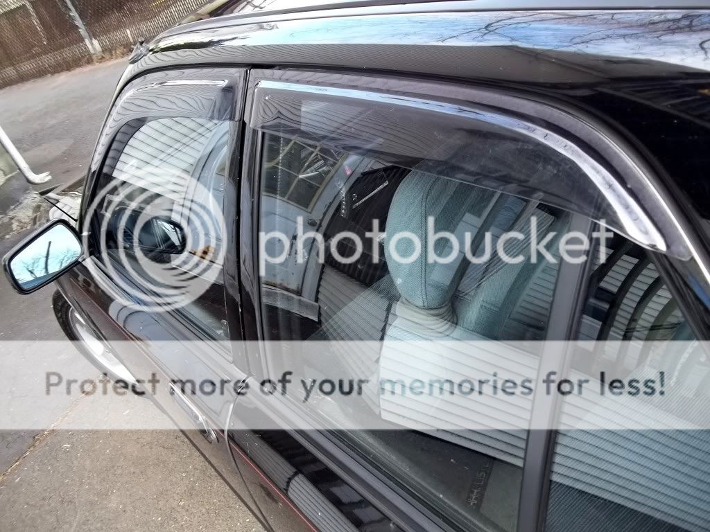

Rainguards::

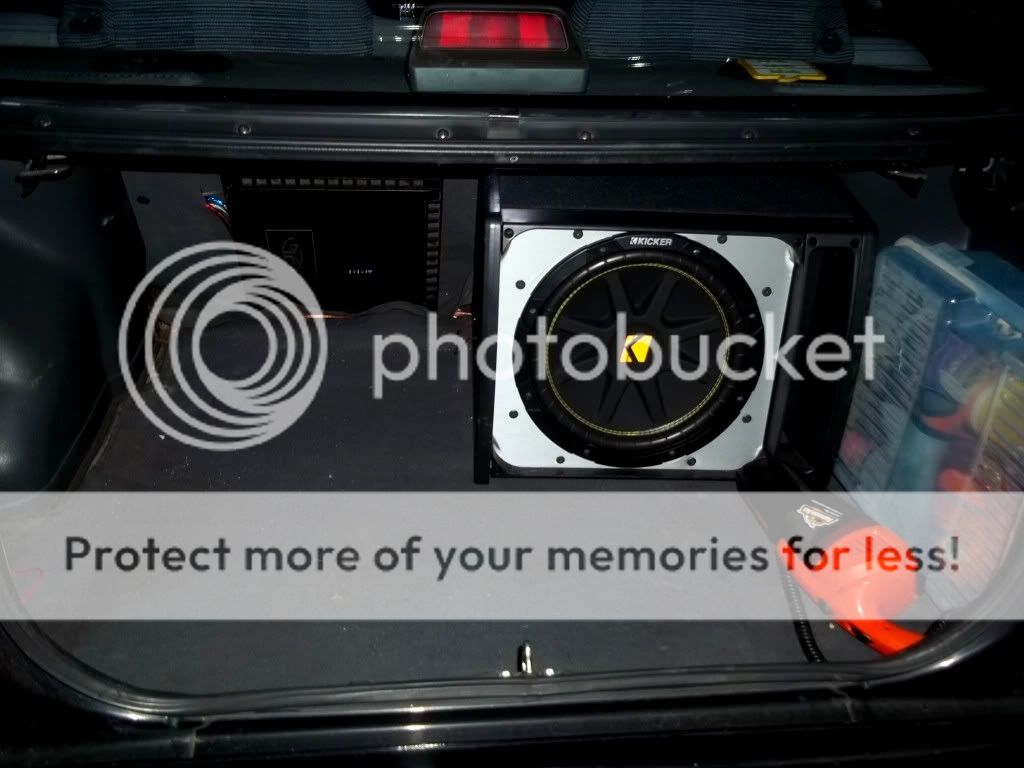

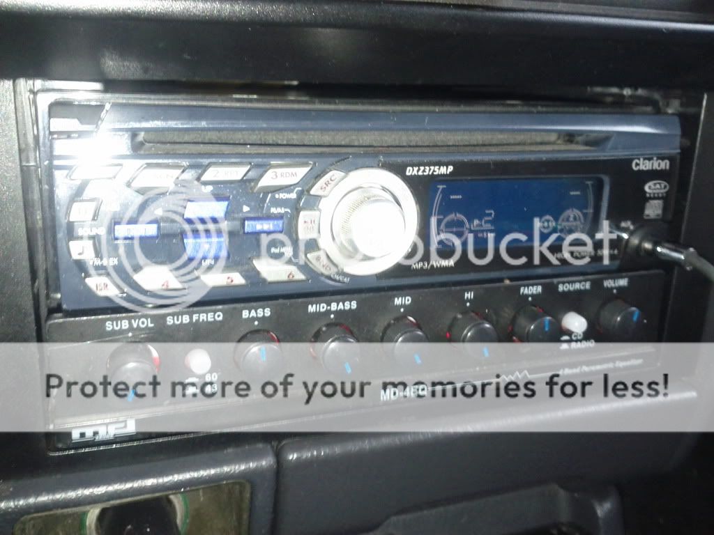

Threw in a Clarion Headunit, MD Audio Equalizer, and Infinity Reference speakers all around.

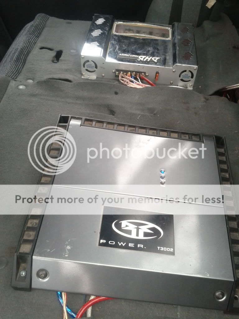

Also a Kicker Comp 12 on a Rockford Fosgate T3002 amp, and a DHD Power Cruiser 600w amp for the Highs.

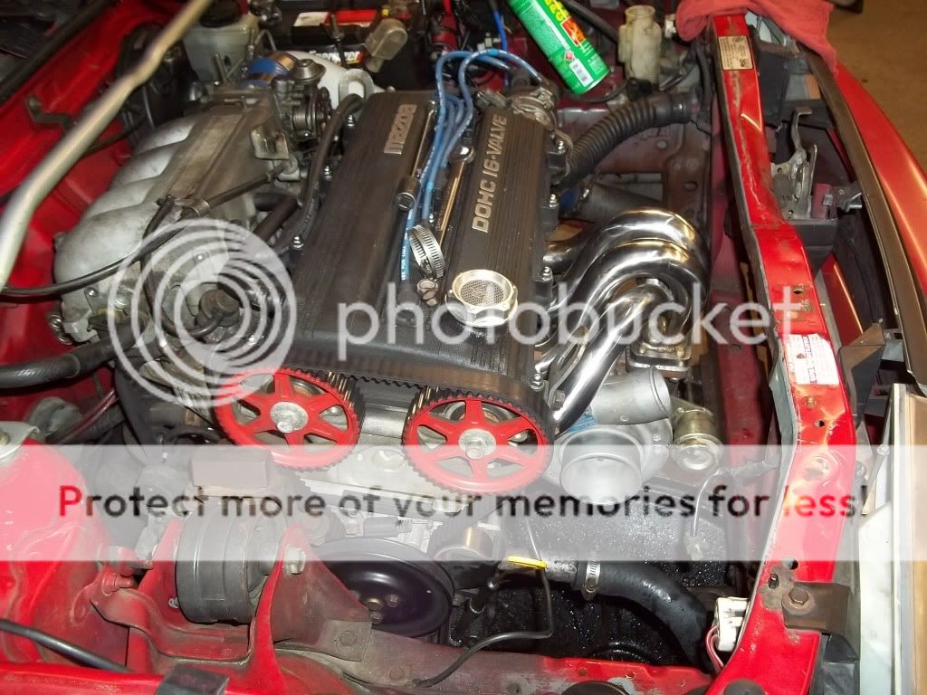

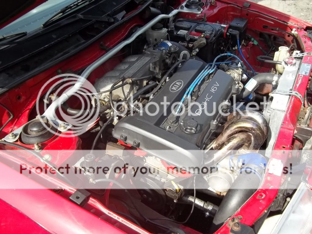

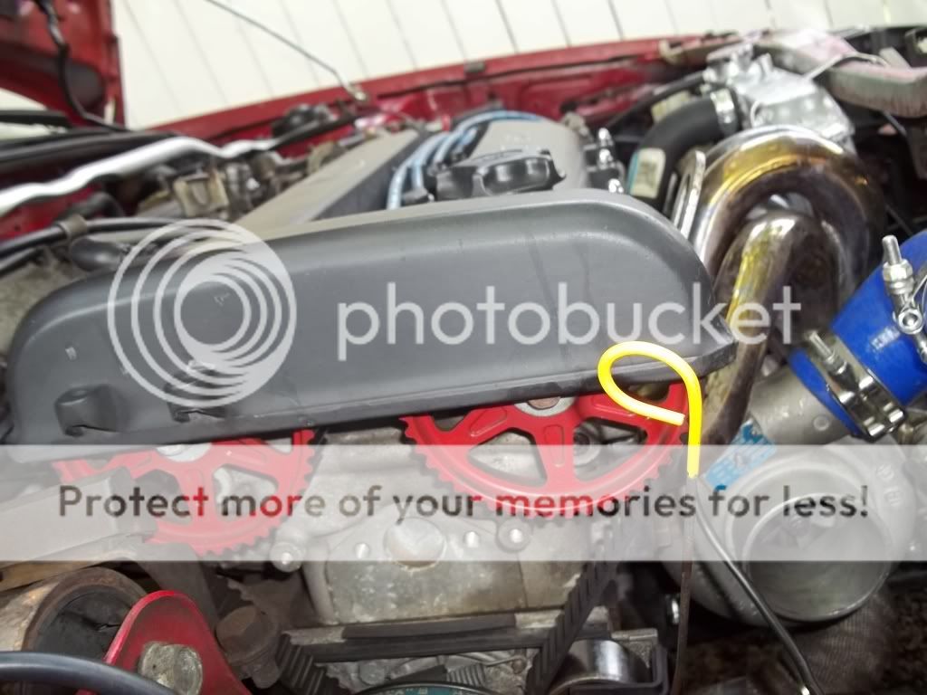

Up in the air.. mostly because of the cold but I have a BP26 Manifold and a blown VJ20 as well as the BP26 Injectors. All I'd need is a rebuild on the turbo, BOV, FMIC, 4wire TPS and BP26 ECU to do a factory setup. We'll see. I may use the BP26 manifold and get a T25 or T3 flange welded to it and do something custom and run MS again.
Here was the last setup in my EGT: I may even do the Kia VC again too lmao
The Kia VC makes me giggle a little bit. BP's ftw.
