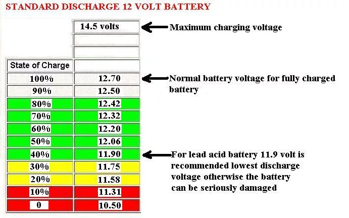

Your 12V battery showing 12.5v is within normal range.
A full/heathy 12V should measure 12.6v (2.1v * 6 cells).
Anywhere between 12.4 to 12.6v is normal.

Let's assume that with a minimum voltage of 12.0 volts, the car engine can start. I made a calculation in which my car can stand in the parking lot if it is not disturbed. According to various Internet sources, a rechargeable battery with a voltage of 12.7 volts has 100% capacity, and if there is a voltage drop due to a current leak to 12.0 volts, it will have a residual charge capacity of approximately 20%. In my case, with a 61 AH battery. and with a current leakage of 60 mA with a security system, the calculation will look like this: 20% of the remaining battery charge capacity corresponds to a residual capacity of 12.2 A.h.. Next, divide 12.2 by 0.06A and get an approximate time of 203 hours or 8 days 11 hours, at which the car is able to stand in guard mode, which after this time, a successful start of the car engine is possible.
When using your data:
You start with full capacity = 100%.
When you end with 20% you have used 80% of the battery capacity due to the parasitic current.
The time to use this 80% of your battery capacity is 80% times 61Ah divided by 60mA is almost 34 days.
My CX-5 started without any hesitation after being parked for 4 weeks while I was abroad.
Thank you for paying attention to this, you are right, I admit my mistake, I was in a hurry. 61 Ah 80% will be 48.8 Ah, which is about 33.8 days, which is very good.
