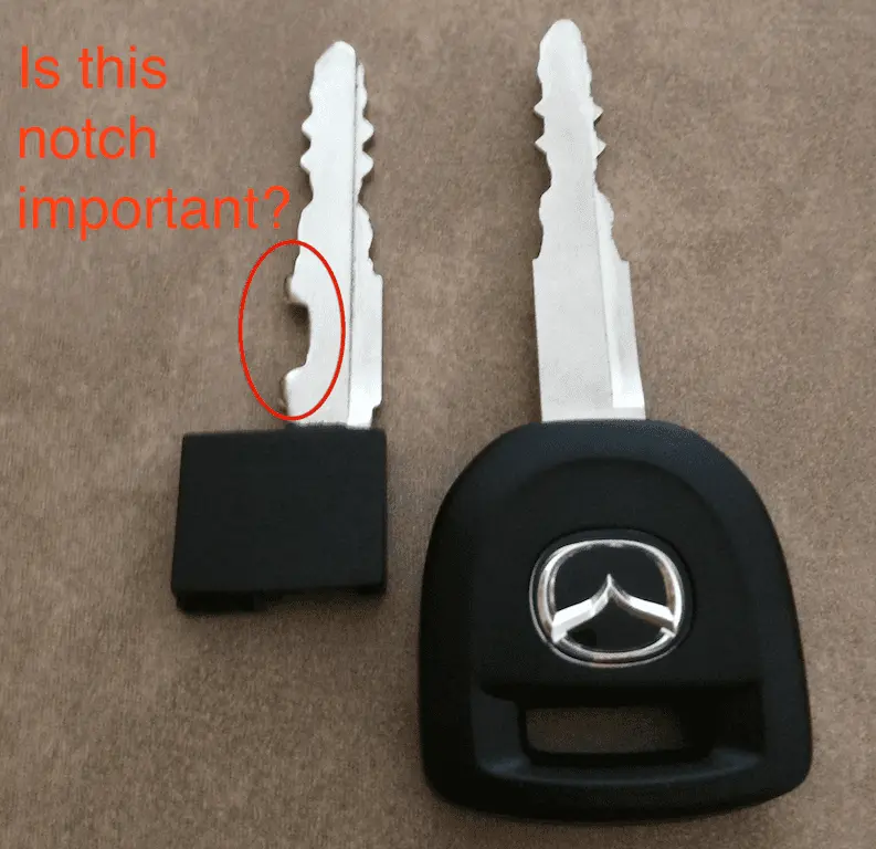

Here is a picture of the new key along side the original from inside the remote: cx9key.webp
Does anyone know if this notch is important and its absence is whats keeping the key from working in the ignition? This notch is used to keep the key inside the remote. I'm thinking the keys may have been cut wrong, I had to take them to a locksmith to be cleaned up just so I could open the door - but I still can't turn the ignition to program the key to the car.
No. The notch is not used to hold the key inside the smartkey/card.
Are you sure of the new key you bought has chip inside (RFID)?
1. if yes, it has to be register to the ECU so that the card recognize it. It does not go by VIN. VIN is not related to registration.
VIN is related to the metal key cutting, not the code registration to the ECU. I can get my friend's SKE card and make it able to open mine.
2. if not, this key can only be used to open the doors, not starting the car. The start cylinder can sense the RFDI inside the key and determine whether to let it turn or not.
I don't have the smartkey/card. My vehicle is a 2010; it has the FOB style remote, there is still a key hidden inside the remote. I'm certain the notch is used to hold the key inside the fob, there is a spring loaded pin that slides into that notch to hold the key inside the FOB. There is a small lever on the FOB to retract the pin so the key can be removed. I just wasn't sure if that notch was needed for the door/ignition cylinders to turn.

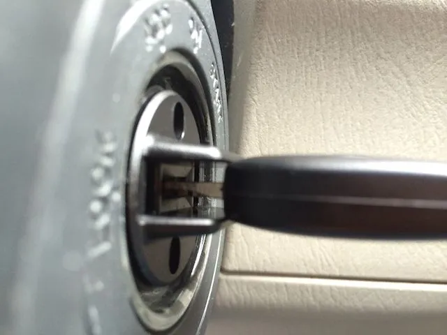

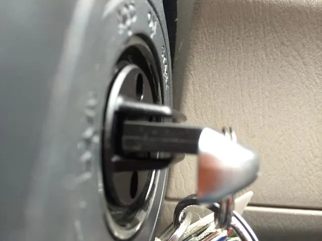

I looked at it again this morning, and I think I know why I can open the door but not start the car. The head on the spare key from onlinemazdaparts.com is too large; I can't insert the key all the way. I'm curious if I file down the rubber head if I can make the spare key work :) If I have some time I might try it. See the attached pictures:
Spare that doesn't work: bad spare.webp
Original Key: original key.webp
