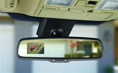

If you don't want/need the navigation system (that includes a backup camera), Mazda offers a auto dimming mirror with the back up camera built into the mirror. Go www.mazdausa.com and look under accessories (audio/electrical) for the CX-9. The kit is about $680 + installation.
Wow had not seen the accessories part of the site, awesome that answers a lot of questions I had about them. Thanks for explaining!
