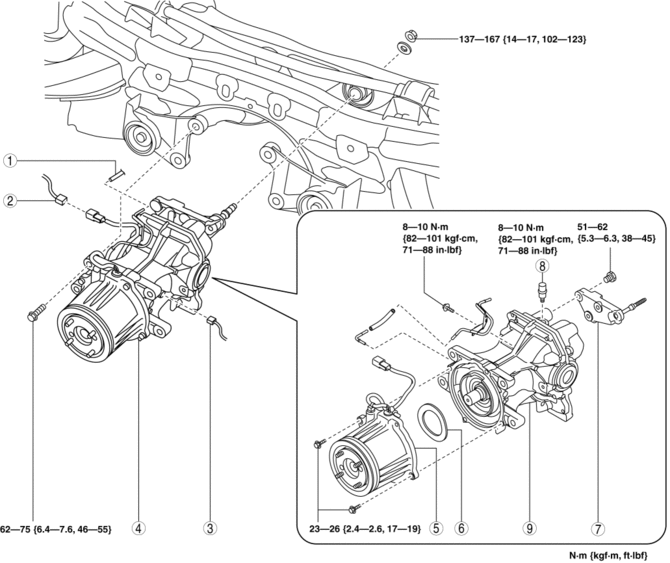

The all wheel drive system is always active, whether it's raining, or not.. The trans is always sending torque to the rear differential, but a slip clutch on the front of the rear diff normally slips, applying ~5% of available torque to the rear diff. When conditions dictate, including using the wipers, the rear clutch tightens and slips less, applying more torque to the rear diff/wheels. Nothing you do with the wipers, or other controls will affect transmission, driveshaft or rear diff wear. Change the lubes periodically.

The rear differential clutch is electronically modulated, ForScan is able to read it's duty cycle in (almost) real time. The readings look like coming a couple of times per second, but the modulation frequency is much higher.
In our '15 the default duty cycle is always between 6 and 12%, meaning that the rear axle is getting 3-6% of torque.When wiper's are on, duty cycle is closer to the higher value of the range, but that's it. It goes way higher into 70s in the snow though.
