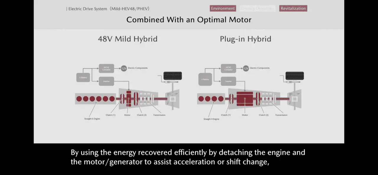

The inline 6 should be a mild-hybrid, not gasoline only. See the powertrain video here:
Thread 'Mazda Large Product Technology Forum'
https://mazdas247.com/forum/t/mazda-large-product-technology-forum.123877682/
And screenshot:
