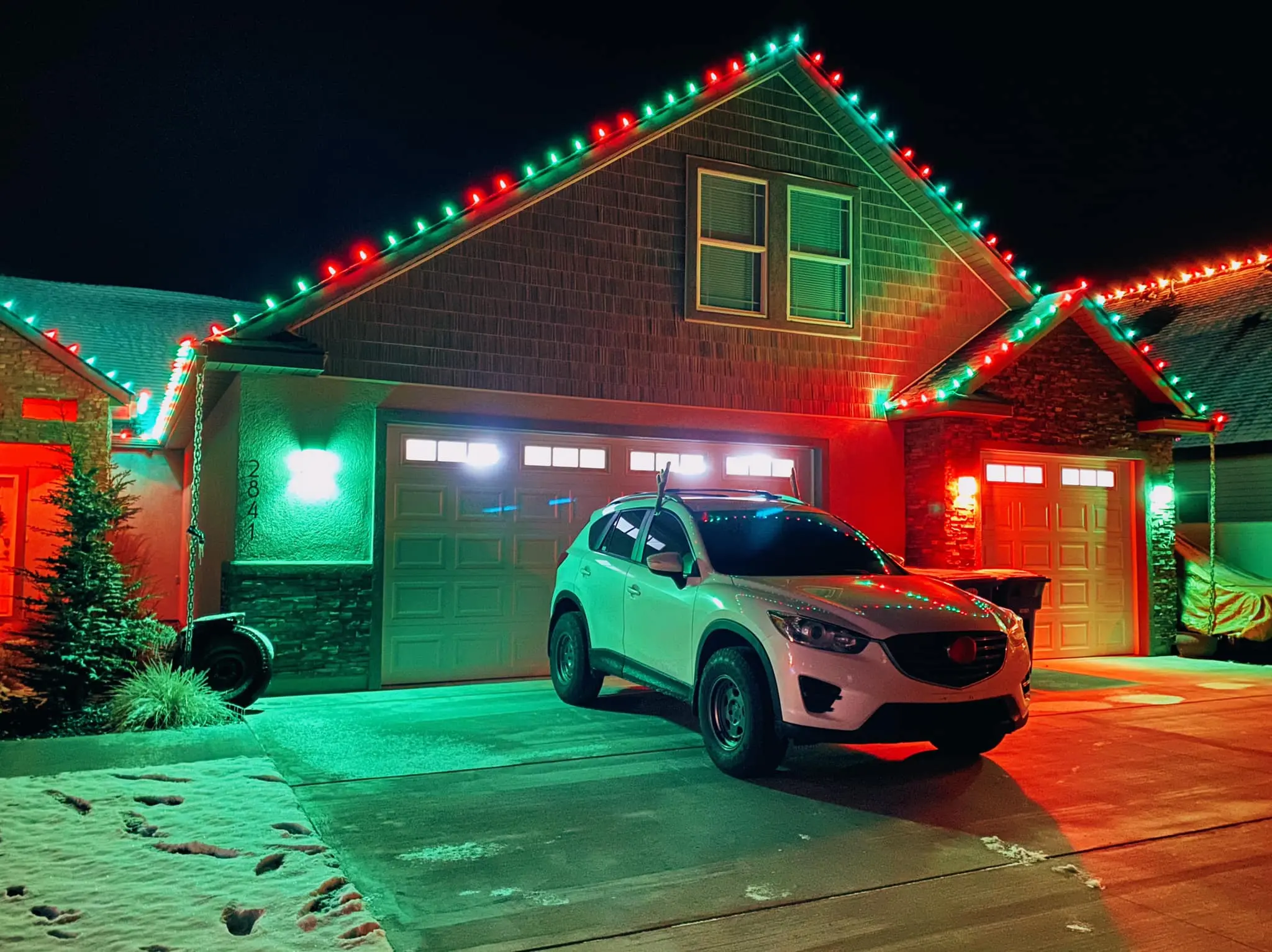

Found a pic of a CX-5 on 16s and upsized tires from the more picture happy CX-5 Facebook Group. There are not many CXs out there running 16s.

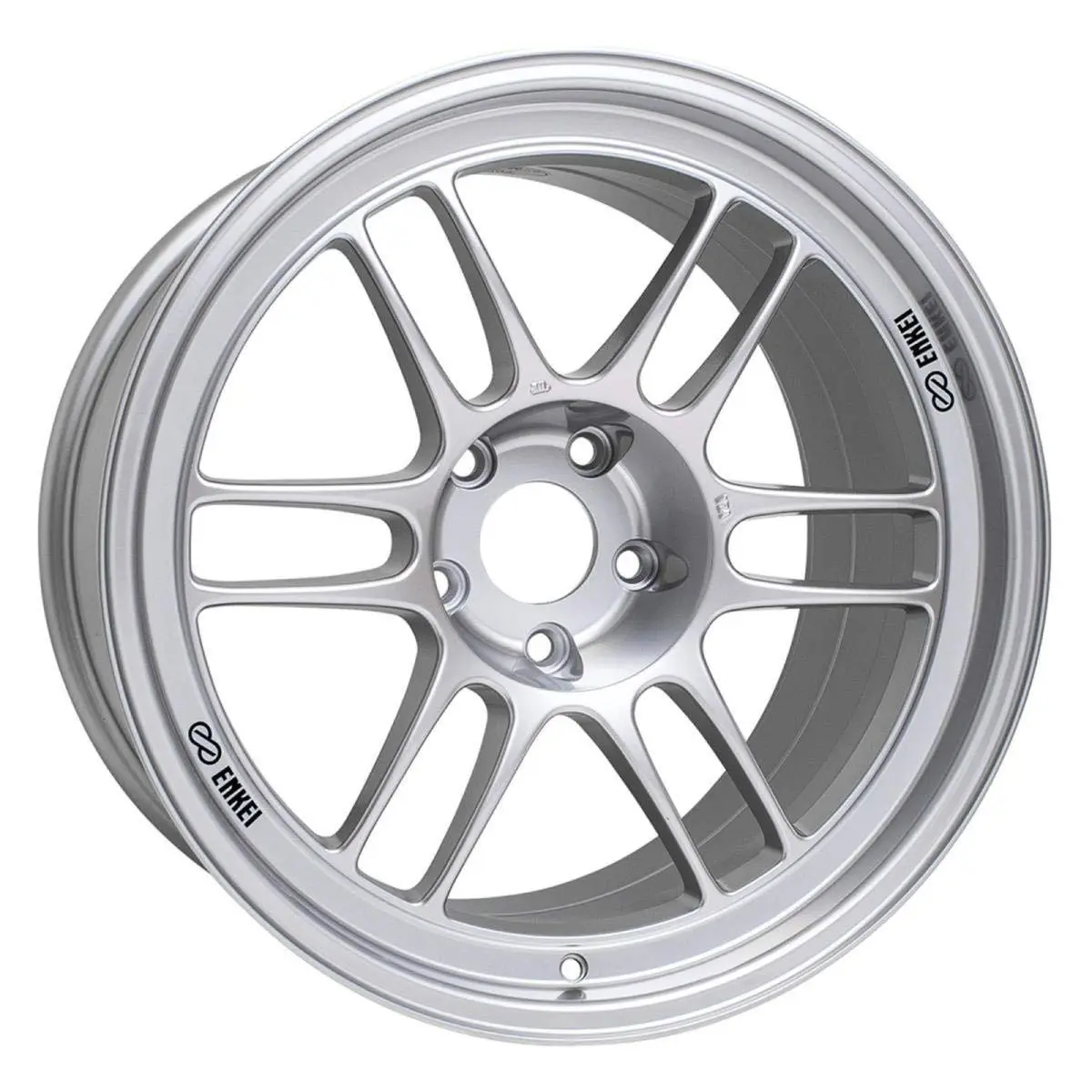

My dream wheel setup is the 16x7 Enkei RPF1, only 13.7 pounds each. Offset is good at 43mm, very close to the 45 offset of the 2017+ wheels. PCD Mazda CX-5 (2017 - ) 5x114.3 wheels | PCD, Offset, Center Bore, mounting and tire size data It is the lightest 16" alloy wheel for this platform. I'll buy them through Amazon because they have a generous return policy; TireRack's return policy sucks - once the product is driven on, they will not take it back, so if you don't like the wheel or tire setup, too bad. Amazon, Costco, or Discount Tire (if there is one near you) will let you return tires if they don't work out. Since they make it expensive and a hassle (or impossible) to return anything, I won't buy tires there, but they are a useful site for information, ratings, and specs.
