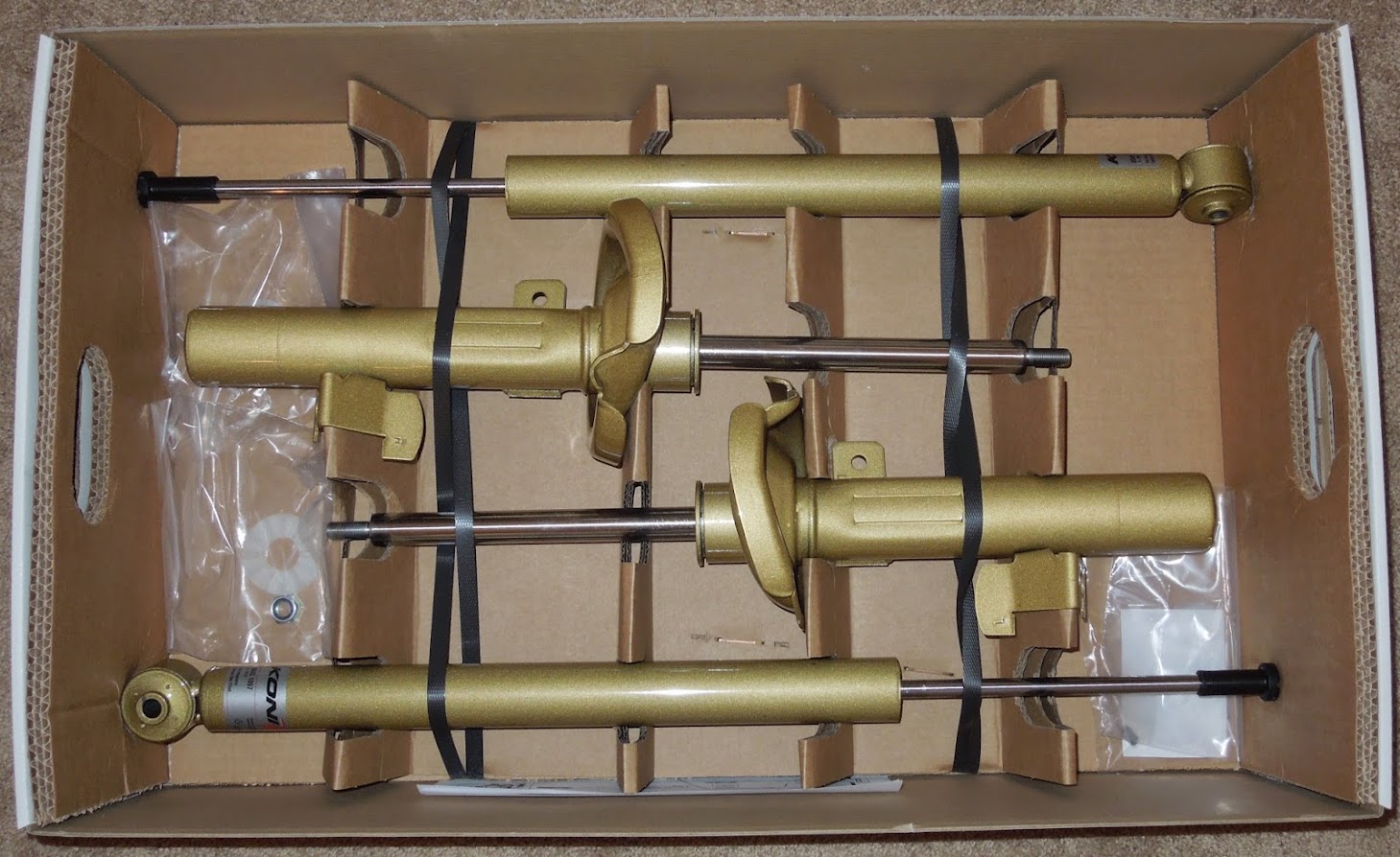

Koni FSDs came today!
nNwq2twlsLNt43Asz62ej07-QfpNj3j2CJWNcOo7I89x=w1459-h894-no
