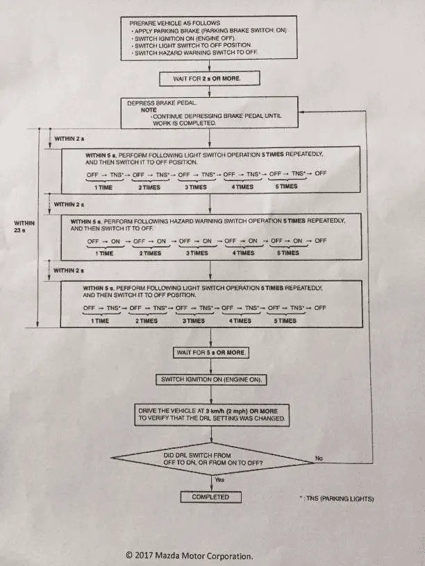

I disabled the DRL's in my 2021 CX-5 using what I believe was the same procedure listed in post #165.
I've attached a couple of the procedures that I had printed out when I did mine.
It's somewhat tricky and it took me two or three tries to get it to work.

We're in the same boat with our new '22 Premium. I tried the "video game" directions and thought it worked, but it didn't. In reading through the manual, it looks like the option to disable the DRLs is unlocked when you sign up for Connected Services, but I wonder what happens when you don't renew at the end of the 3 free years - does the car reset to default settings?
I will likely pull the DRL relay and just switch the stalk to the parking light position to achieve the look you posted in the picture.
If anyone with a '22 has experienced success with the "video game" method of disabling the DRLs, please let us know in this thread!

Just providing my input regarding the ridiculous procedure (that could simply be a menu setting).
It says "within 2 seconds," but it isn't. You need to do the whole thing very quickly for it to work, in my experience. When I did the steps with a ~1 sec delay between steps, it wouldn't work, but with less than that, it did. Lots of people had difficulty with it.

Thanks - I'm going to give it another try today. Any input on whether it's ignition position 1 vs 2? The document doesn't explicitly call out one or the other.
Well, I couldn't get the documented method to work on our '22 so I simply pulled the DRL relay. Mission accomplished!

for future reference if somebody looks for this,
The same procedure (the steps with the light switch and hazard light switch) works on cx5 2022 to disable the DRLs. One just have to be quick in doing it.
