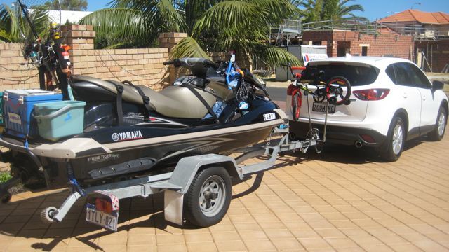

This what I tow on the weekends- Fishing Ski/bikes/normal weekend luggage packed in the back. The CX5 drives comfortable with the load, I do notice that it alters the rear vehicle height,so I'd think your CX5 would be the same with a horse trailer on the back. Fuel consumption goes up to 13.5L to 100k's when towing,but I do use the manual mode on the gearchange more when towing,up the hills.
What's the total weight of your load?
The Ski is 400kg,plus 70litre's fuel in the Ski(if I fill it before we leave). I suppose with everything packed in the car plus the Ski,it would come close to 500kg.
