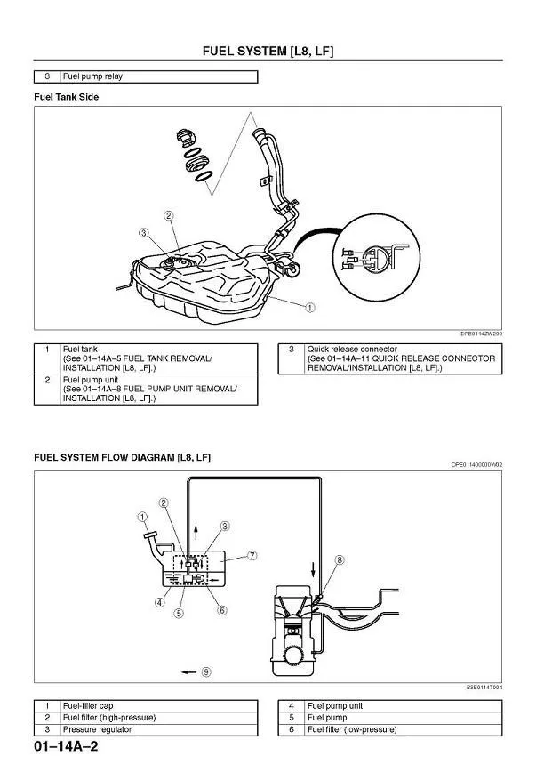

The dealer is correct. There are actually 2 inside the tank.

Here is the text from a couple of pages after flcruising's attachment. In a nutshell there is a fuel pump unit which includes the fuel pump, both the low and high pressure filters, and the pressure regulator. The reason why the filters were included with the fuel pump was to “simplify the fuel line”, and the reason why the pressure regulator is included is because of the “returnless fuel system”.
The "good" news is that while the unit is in the gas tank, there are quick connectors to easily get to the pump. The days of having gasoline dumped on your arm as you take off the fuel filter are over, as are the days of cheap fuel filters.
To give you an idea of the price, MSRP of this fuel pump unit is US$241.85 though you can buy it for US$188.60 at Montogomery Mazda, probably a similar price at Med Center Mazda.
RETURNLESS FUEL SYSTEM OUTLINE
Features
• The returnless fuel system reduces fuel evaporation in the fuel tank.
• The pressure regulator located in the fuel tank prevents fuel return from the engine compartment side, thereby maintaining a low fuel temperature in the fuel tank. Due to this, formation of evaporative gas produced by a rise in fuel temperature is suppressed.
• The pressure regulator is built into the fuel pump unit in the fuel tank.
RETURNLESS FUEL SYSTEM OPERATION
• Fuel in the fuel tank is pumped out through the fuel filter (low-pressure) by the fuel pump, filtered by the fuel filter (high-pressure), and then regulated to a specified pressure by the pressure regulator.
• The pressure regulated fuel is sent to the fuel injectors.
• After pressure regulation, unnecessary fuel is returned from the pressure regulator to inside the fuel pump unit.
and a couple pages later:
Fuel Pump Unit
• Mainly consists of a fuel filter (high-pressure), pressure regulator, fuel pump, fuel reserve cup, and fuel filter (low-pressure).
• A pressure regulator is built-in due to the adoption of a returnless fuel system.
A hard-plastic fuel pump unit, with an integrated fuel filter (high-pressure) and fuel pump, has been adopted to simplify the fuel line.
• Fuel in the fuel reserve cup is suctioned out through the fuel filter (low-pressure) by the fuel pump, and pumped to the fuel filter (high-pressure). Return fuel is sent back to the fuel reserve cup or the fuel tank through the jet pump.
• If return fuel pressure exceeds the specified value, the relief valve discharges return fuel into the fuel pump unit without passing it through the venturi. Due to this, return fuel pressure is maintained below the specified value.
Pressure Regulator
Built into the fuel pump unit due to adoption of a returnless fuel system.
• Mainly consists of a spring, release valve and diaphragm.
• Pressurizes fuel discharged by the fuel pump to approx. 390 kPa {3.98 kgf/cm2, 56.6 psi} using the spring, diaphragm and release valve, and then pumps it to the fuel distributor.
• If fuel pressure exceeds approx. 390 kPa {3.98 kgf/cm2, 56.6 psi}, the release valve opens to discharge unnecessary fuel pressure.
