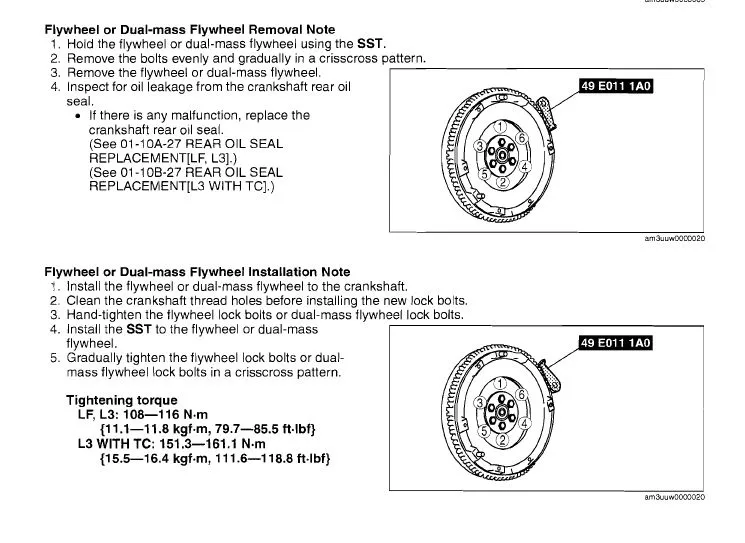

Make sure they are torqued in the correct pattern as well.
