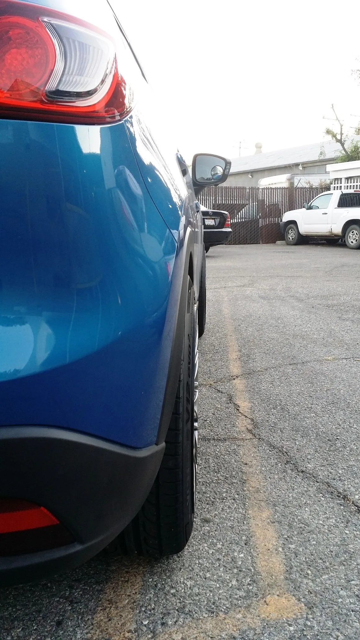

I have 35mm offset, with 9.25" wide wheels(20" dia.) and dropped 3.25" lower. No issues.
Mine sticks out 5mm even more, that the 40mm would. I have a bit of a tuck, with narrower tires.
attachment.php
