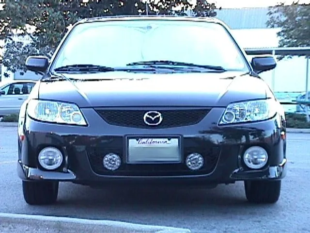

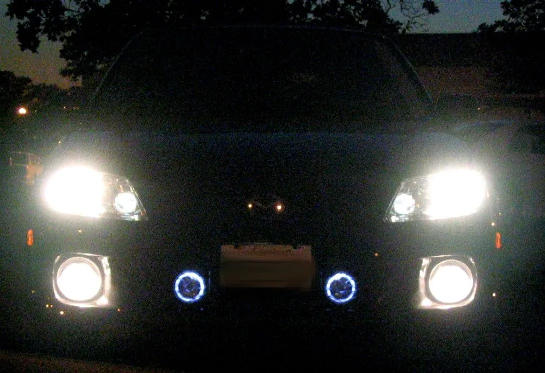

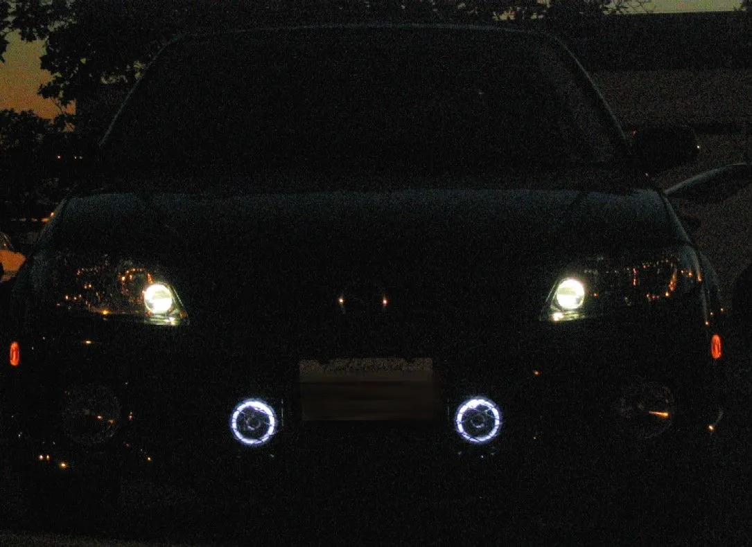

Got some "Angel Eyes" fog lights and installed them behind my lower grille. Here's some pic's...what do y'all think?

nice... placed in the spot the matrix has them (bleh) since you're in So Cal i don't think i'd roll around with both sets of fogs on... get a ticket
Yeah, I mainly wanted them for the style of the "Angel Eyes". The main part of the lights are on a switch so I can turn them on when I want the extra light. Probably will use them more for when I'm trying to see on a dark road with or without my brights.

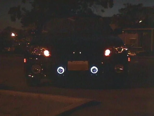

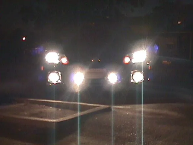

Here's some new pics. I replaced the amber parking/turn lights with some super whites that match the fog rings better. I tried several bulbs and this was the closest I could get....grrrrr! I think it looks better, though....what do you all think?
