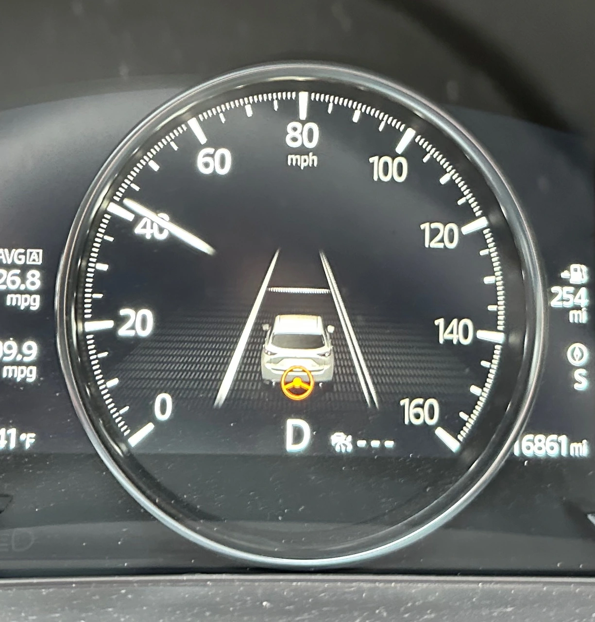

I think I may know what you're seeing, could it be a steering wheel icon rather than a Mazda emblem?
I see an amber steering wheel icon occasionally on my 2024, also saw it on my 2020. I do not know exactly what it signifies, maybe something to do with the Lane Departure System. I can't find anything about it in the manual.
This one?
This one. It's definitely associated with Lane Keep system, comes on when I get close to center line or fog line.
The light comes on as soon as Lane Keep Assist actively helps with steering.
