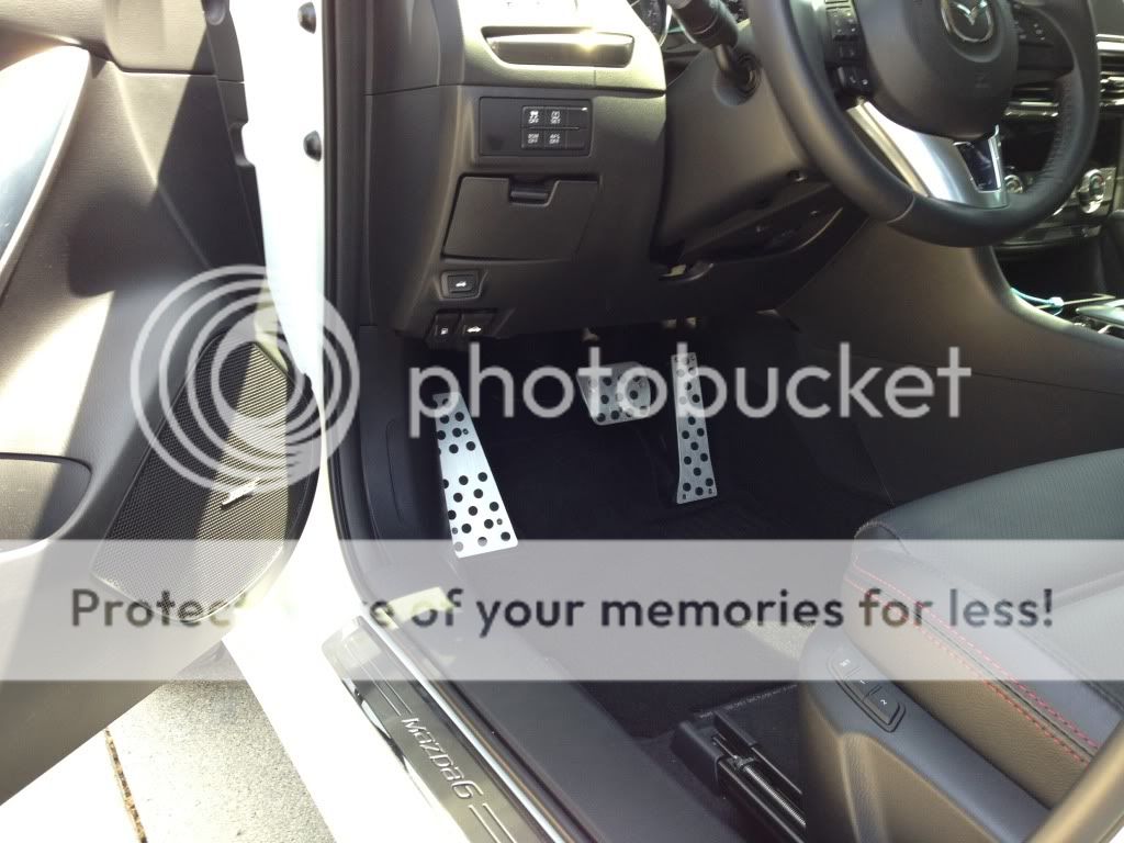

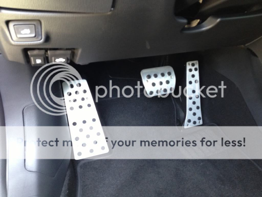

My pedals arrived today and I got to work installing them. These were aluminum pedals for a 2013 CX-5. These were made in China and from EBay. I had a $10 credit ans $10 of EBay bucks, so it only cost me $15.50. These are the same ones sold by Mazda before the CX-5 logo is etched in and is only a quarter of the cost.
Did you have to drill for all the 3 pedals?
I would imagine he did. I would even if they did not require it. Keep in mind these are covers going over your existing pedals. The last thing you want is that cover to slip off your brake pedal as you are approaching a stop light.
I just realized I did not post my step by step installation. Yes, the foot rest crews right into the plastic, the plastic gas pedal had to be drilled through and is held by a nut, same for the steel brake pedal which is also held by a nut. You only remove the rubber cover on the brake pedal.
