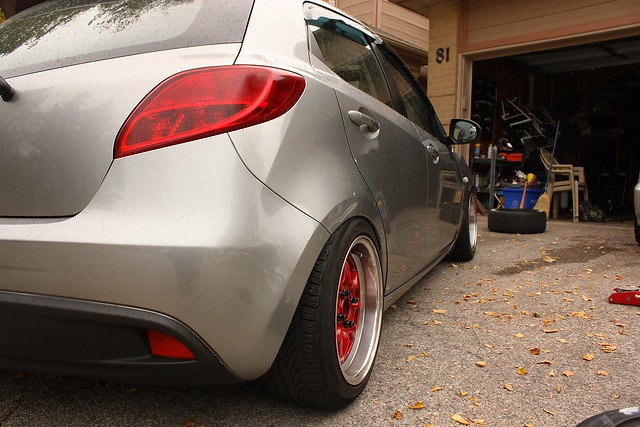

No but seriously, yes to get ready for the new wheels. With the new amount of negative camber, the new wheels should fit nicely back there. Also, adding that camber gave me a bit more lows in the rear end.. I'm tucking tire hard in the back now. BTW, I don't have TC or ABS anymore.. I popped out the fuse, or else, you're in for a world of ****.
That amount of - camber was gained with 2 washers per lower bolt on the stub axle. I have some pics somewhere of the assembly taken apart, but in similar fashion to before, I didn't take pics of the process... what a build thread eh guys lol.

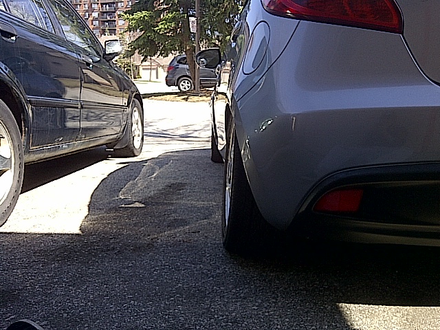

Alex what is your frame to ground clearance?
I think just under 2 inches, or right around. With these new wheels on and the tire setup I wanna run, it'll be closer to 1.5 inches off the ground. My exhaust has about an inch of clearance to the ground, at it's lowest point haha.. I need to get that fixed

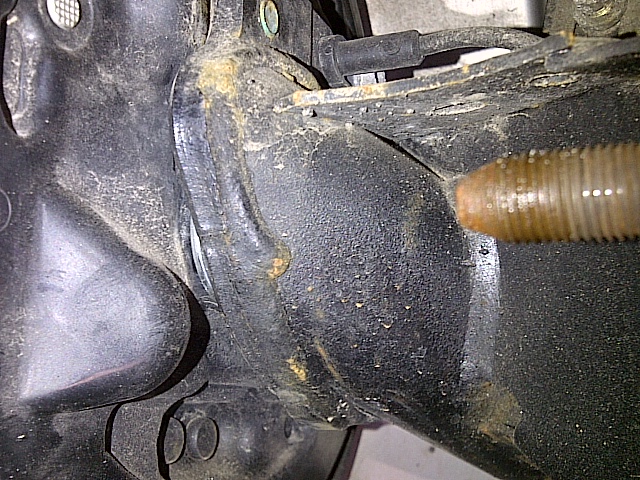

Here's a pic with last years wheels of the subframe clearance:
IMG-20121013-00352 by Alexander D.24, on Flickr
