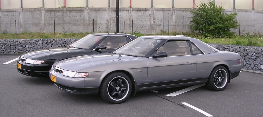

Hi to you all,
On the gray Cosmo the airpump behaves strangely: it switches on and off. I'll post a video on Youtube later today.
Any advice on how to repair this would be very much appreciated.
Thanks to you all and greetings from a very sunny Amsterdam - The Netherlands!
Jaap
