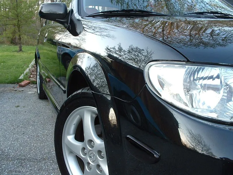

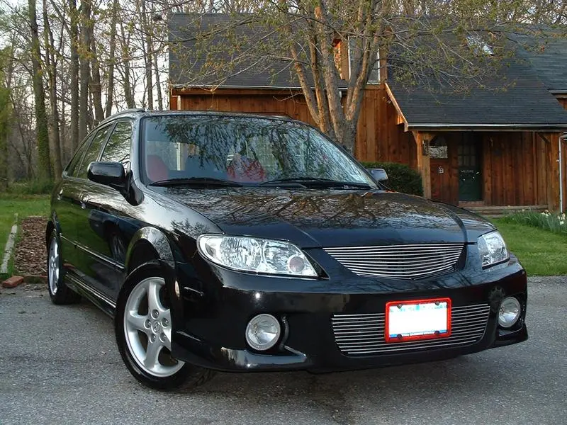

I just did this to my amber sidemarkers a couple weeks ago and they turned out great (see pic attached). I used VHT Niteshades that I ordered from my local speed shop and did about 3-4 coats because I wanted it BLACK. It was a simple process, I popped them out, cleaned them w/rubbing alcohol, propped them up, painted them, waited the recommended curing time then reinstalled them. I think they look sharp and I haven't gotten any heat from the coppas on them yet either. Then again I have a black mica P5 so it bleeeeennnds. :D

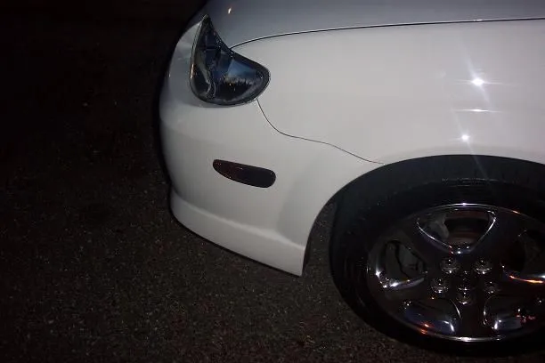

I did mine and they looks bad-ass (glare)

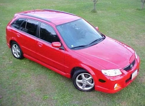

Hey no problem! :) Ok, here's my quickie photochop, hope this gives you some ideas. :p I think the black sidemarkers would go very well w/your black on red theme. Much better than amber! :D
