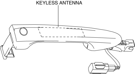

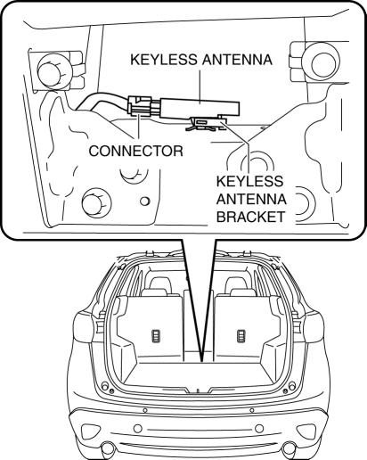

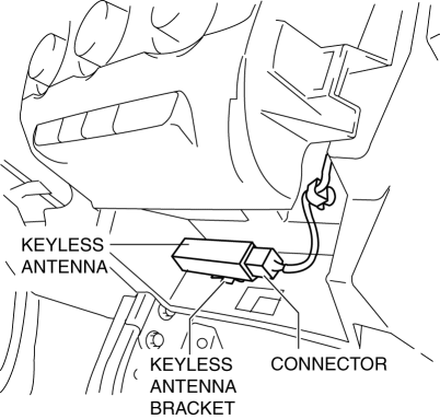

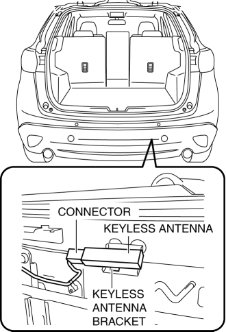

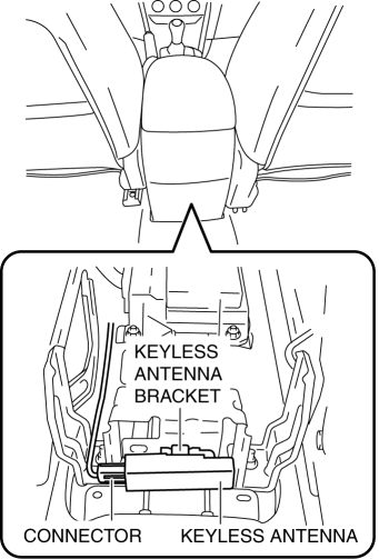

I think you're correct. I think the atenna and receiver are the same as what's used INSIDE of the car for keyless start..hence I think there are three such antenna/receivers that need to be purchased. One for the hatch, and two for the doors. I need to figure out their locations first and order up one set for testing. Because the distance is so short these units must be residing in each of the doors or very near them..I'll call the dealership up because I'm not sure where exactly they're mounted.
Based on partnumber searches, there's only one type of keyless detector/receiver for everything.
So looks like 2 door handles, a rear receiver internal and external, beeper module for the front of the car, module (I think it's already installed for the ability to detect internal key).
I think center console and stereo console antennas, and receiver are already installed so as to allow for the car to start without a key. I'm going to take a gamble with getting just the rear hatch receivers and maybe the buzzer for the front.
The only ultra PIA from what I could understand, was removing the door handles. You have to remove the window glass and the door handle is tricky to take out..

I didn't see the actual door handle in your part list, so I found it here:
http://www.mazdapartsunlimited.com/...up=lock-and-hardware&part_name=handle-outside
Not sure if you had a different plan or if I just missed it in your parts list.

That shouldn't be the case the cost is 2 door handles 60 a piece, a beeper under the hood, and a rear bumper antenna.
I haven't had a chance yet. It's freezing, raining, or snowing in boston so doing this is a giant paint with crap weather. I'm hoping to try it next weekend on the rear bumper.
You also need the LF control module which is only for the advanced keyless entry. Not sure if the wiring is pre-installed or not, but the module is not there in standard setups. You need all five antennas for the system if you want the system to function correctly, 2 of them sense if the keys are in the car so the doors won't lock. All the antennas plug into LF module, not sure if they are prewired. The advanced keyless entry can be enabled/disabled using the M-MDS tool, so my guess is it is disabled and would have to be enabled by a dealer if installed. My guess is at least $500 and that assumes that a dealer would enable the functionality for you.
The lF control module, is different than the receiver.component in rear left quarter of the cargo area? Is there a part number that you know of for it? Or location where it sits. I can troll some junk yards for a junked gt.
Wait it's that bottom left connector in the driver lower left panel...I'll take a look and see what that looks like.
