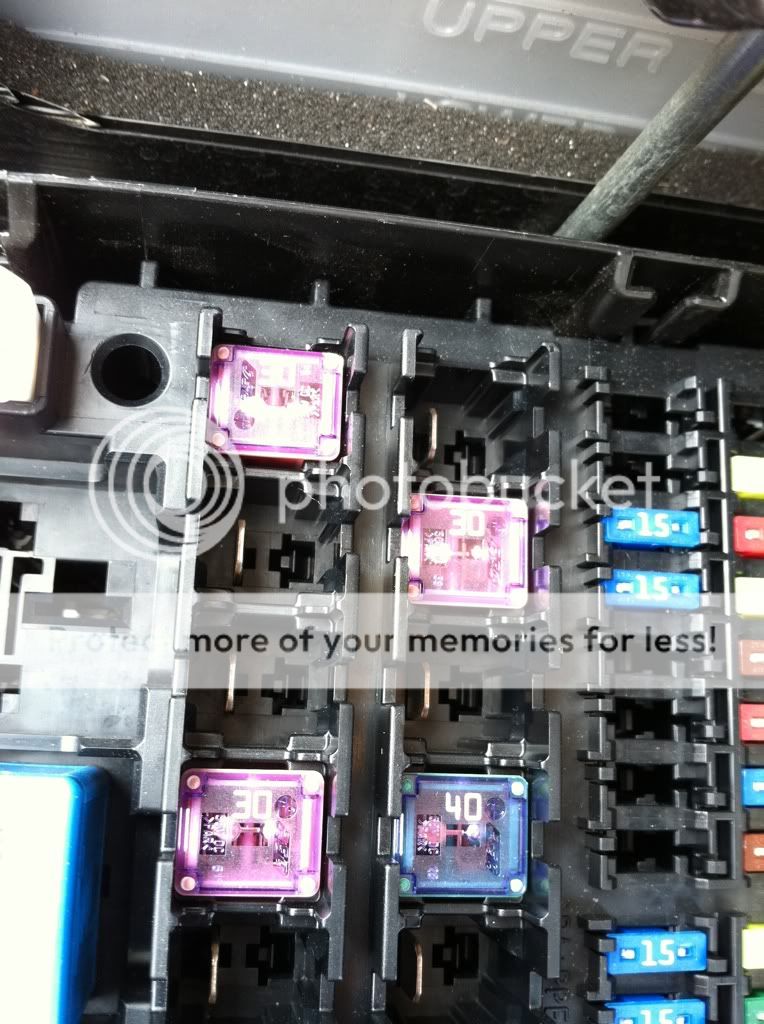

Last night I'd just about had it with the over sensitive ABS so I pulled into a Sheetz and went to pull the fuse to try it out.
Disclaimer: Before anyone chews me out.... The past 3 cars I've owned did not have ABS. They also had aggressive brake pads. I pulled the fuse on my Miata and ran it for years like that. I understand this is not the "proper" way to do this (I am doing it the proper way on the Miata now).
Here is what I found:

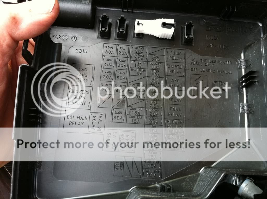

(upper left corner of lid, ABS, 40A, right under the blower fuse)

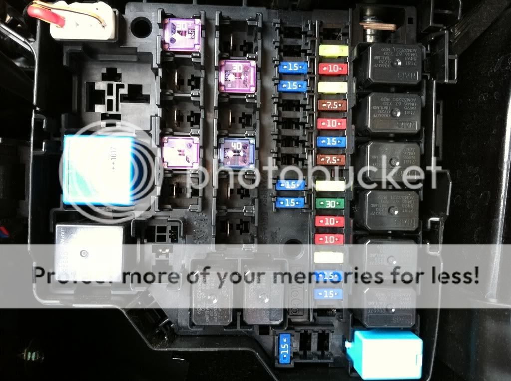

But yet, here's my fuse box:
Notice, NO ABS fuse........... what gives?? I checked the fuse box inside the driver door dash area, no ABS fuses.
Any ideas?
No one? I'd really like to control my own braking... As opposed to having ABS kick on on a downhill turn almost putting me into a guardrail at speed like it did tonight....

Dang! Sorry about that. I looked the other day and behold I saw the same thing. No fuse. This is quite weird, however, I think the abs might is tied into the traction control system and those operate off the same fuse. Further investigation is needed.

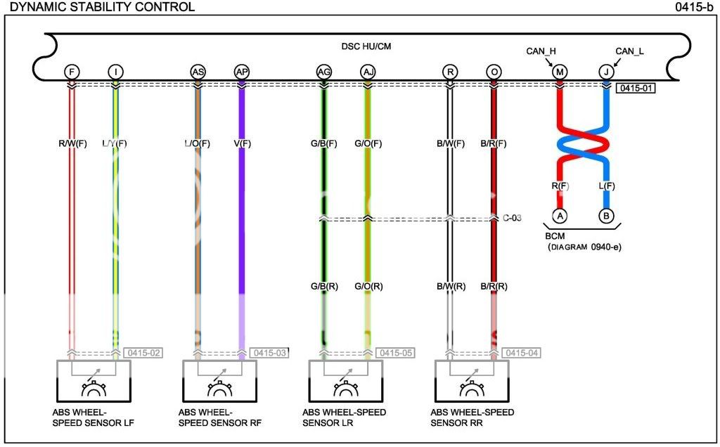

OK. How about unplugging one of the wheel speed sensors (each corner has one). That should shut off both ABS and the Traction Confusion.(rei)

Splice a switch into one of the ABS sensors so you can disconnect it and kill it when you want to?

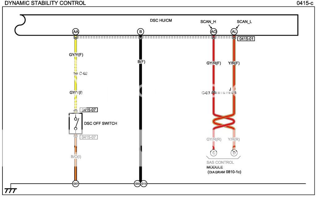

Since it sounds like it's happening during spirited driving and on loose/wet surfaces, that doesn't sound so much like an ABS-specific problem but rather the traction/stability control. I'd suggest, before you all start unplugging sensors and pulling fuses, get in the habit of pressing the "DSC OFF" button on the left side of the dash every time you start the car, and see if it behaves more to your liking. IIRC it won't disable the ABS on its own (so you'll still have its benefits if you have to panic stop) but it'll keep the car from nannying you during hard cornering.
I almost always have the DSC off, it's all ABS :(

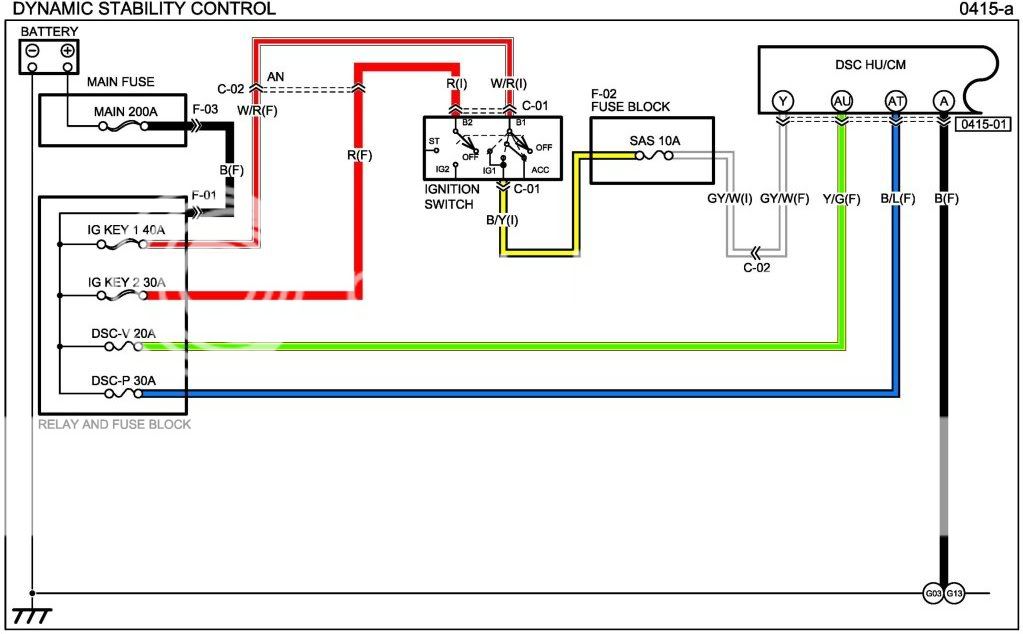

The ABS and Traction control (as well as the speedometer and cruise control) all operate off of the same sensors. There are two wires going to each sensor. One simple Hall Effect sensor at each corner of the car.
Unplug or sever or splice a switch into one of the front sensors and your traction control and ABS will take a vacation. Disconnect two front sensors and you lose speedometer and cruise control.
All you would have to do is cut one wire and hook a switch in place (extending the wires to the dashboard of course).
