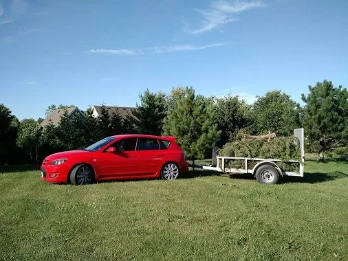

I pull this 5x8 around with my car and the wife's CX5. Works great!
A 5x10 won't be much different, with either you just need to be careful not to overload it too much. Hauling junk to the dump, compost, woodchips, riding lawnmower, lumber, all no problem.
That gate / ramp on the back sucks though, it feels like you're pulling a parachute. I haven't tried getting on the highway with the ramp up behind the CX5, but I'm sure it would be miserable. Around town / under 50mph, wind resistance isn't really a problem.

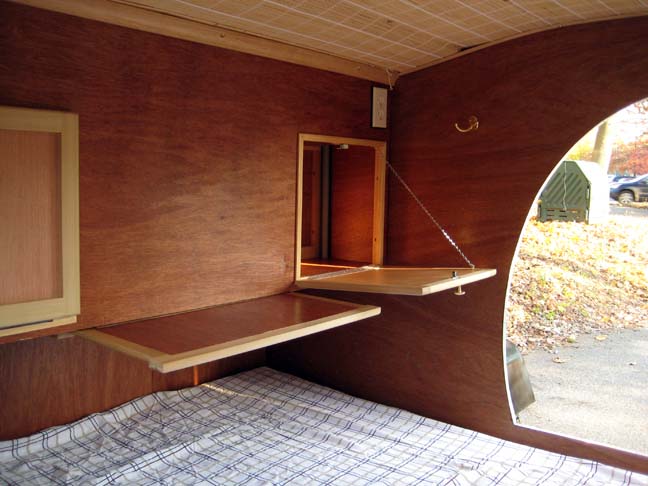

I tow a 5ft. wide teardrop with absolutely no problems. Wider than 5 ft you'd need auxiliary mirrors but with 5 ft. your just fine.
Here's a link to my build journal on the tnttt.com forum if you want to see how it was built, and here's a journal of a refurb done after our first cross country trip
Here are some pictures:
As it is today (with diamondplate and art deco "wings" on side, done this past summer):
Towed behind my Miata before I painted the mill finish aluminum (part of the refurb):
View of the interior (looking towards the back thru one door):
