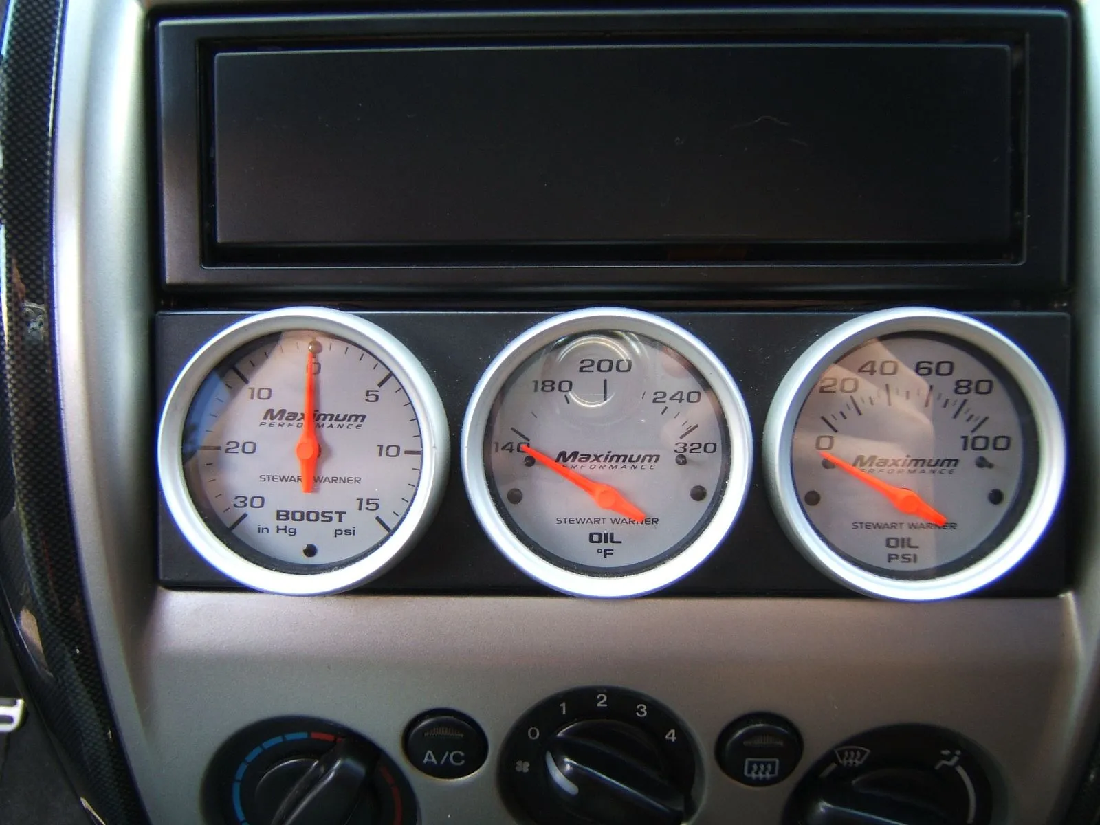

i have the 42nd draft design guage holder for the vw. i superglued some plastic on the back of it to make it fit inbetween. the support and the cover . it just snaps in place. i also used wetherstriping foam to secure it so it doesnt rattle. i see if i have some pics. i ahve stewart warner guages too. i have the vac boost guage for 15 psi. moves alont

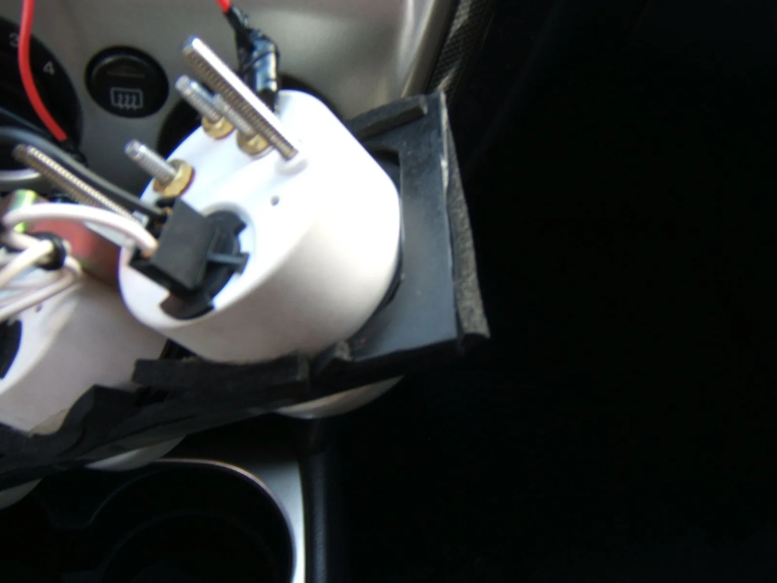

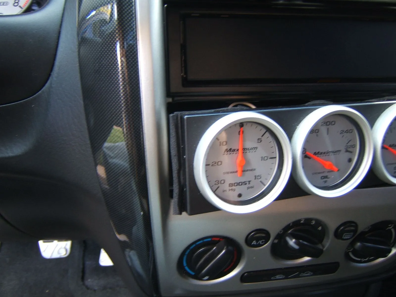

it looks kinda bad from the back, but that isnt what ya see in the car. and it only takes two seconds to take on and off and no doiuble tape residue. maybe once i get all my guagesw in where i want them finally i will secure it better, but for now. it holds tight and doesnt move
that looks great!
Thanks ?a bunch. Are those 2.16 gauges?
I will follow your steps.
Vampyre said:
yeah those are 2/1/6 guages
