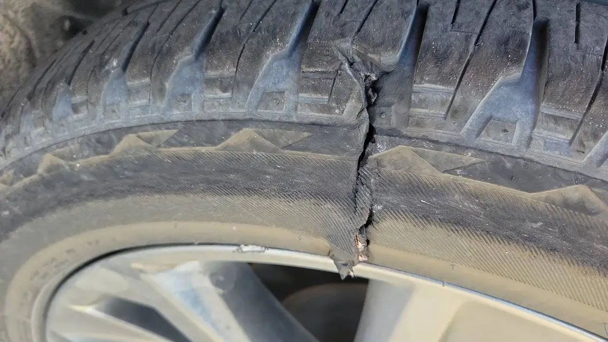

I'll get more info Wednesday on what exactly they are doing. Shredded tire, I'm surprised it didn't blow... I hit whatever did this about 3/4 mile from the dealership and it drove fine. Bridgestone duellers must have very stiff sidewalls!

I'll get more info Wednesday on what exactly they are doing. Shredded tire, I'm surprised it didn't blow... I hit whatever did this about 3/4 mile from the dealership and it drove fine. Bridgestone duellers must have very stiff sidewalls! View attachment 296506
Whoa. No damage to the rim?
Wow, that is a massive cut. Can I ask what you hit?
no idea, I was in the right lane on a 6 lane road, and police car to my left, so I glanced over at him and that was the moment i ran over whatever was in the road... I think it was something flat that I ran over and my front tire kicked it up at just the right angle for my rear tire to run over.

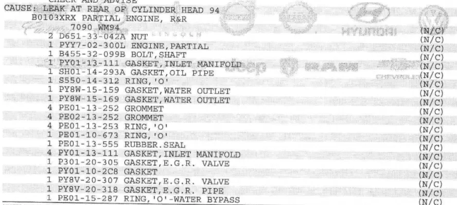

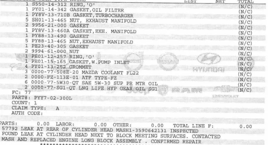

failed cylinder head was the cause, I'm still waiting for the full writeup.
the master ase who was doing the tire change was checking the vehicle, noticed the coolant was low, went to fill it, and it didn't fill up the coolant, so he deduced it was going somewhere else, he checked the oil and the coolant was mixing into the oil.
I'm still in a loaner vehicle, pickup is supposed to be tomorrow or friday, when I'll get all the paperwork.

Yes, looked it up, but I can't find a description of what that entails. How partial an engine is that? Looks like they did the differential fluid, transmission fluid too. Scares me when I see all those gaskets and seals... if one of those is put in wrong, it's just a problem waiting...
Well, I checked most of those gaskets, none of them is a head gasket, so it looks like it's the full engine to me. I too am curious as to what partial engine means, unless a full engine means engine + turbo + transmission + all other bolted on stuff as well.
2010 CX-9 GT
From the looks of the list, they had to remove the exhaust manifold and turbo from your old engine and swap it to the new one, along with the intake manifold, EGR valve, and parts of the cooling system. When they removed the exhaust manifold they had to replace all the exhaust gaskets between the turbo and exhaust manifold and the rest of the exhaust system as well.
