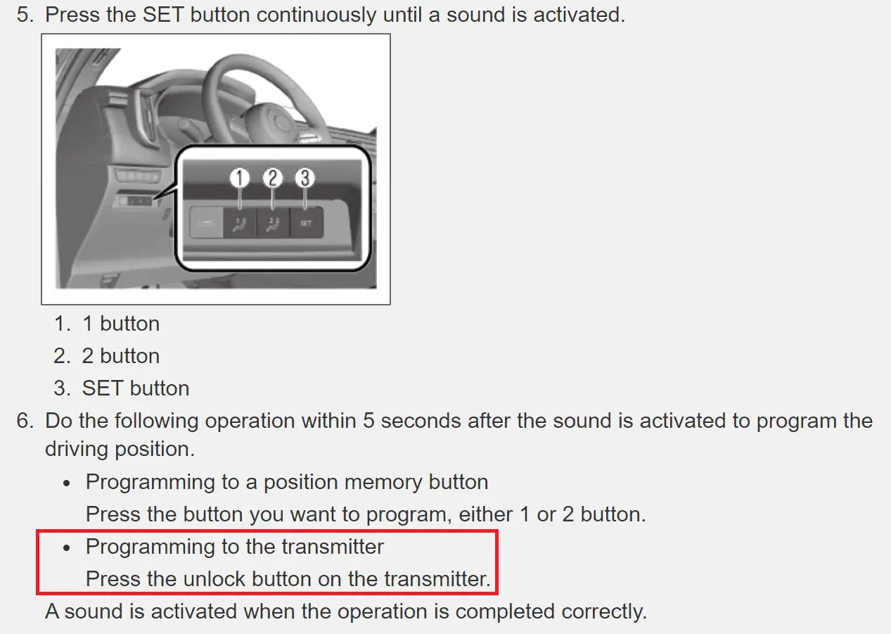

Issue has been resolved. It appears that there was a step in the manual that I glossed over. Here the steps that worked for me:
  1. Ensure the car is fully off.
  2. Press on the push-start button twice to place the vehicle in accessory mode. Note: You'll see your touchscreen display and everything on your dash power on.
  3. Adjust the seating position and mirror position to your liking.
  4. Hold and press on the "Set" button and wait for the chime.
  5. Hold and press on the "1" button and wait for the chime.
  6. Press the "unlock" button on your key fob and wait for the chime. Note: If you do not hear a chime after pressing on the key fob, repeat steps #3-4 and then press the unlock button on your key fob and you should hear the chime.
It may take multiple attempts to get familiar with the process.
