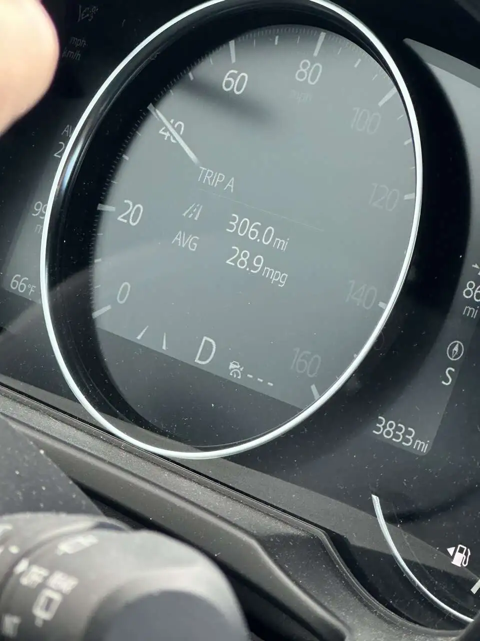

I am lucky my 2023 turbo with 4000 miles gets 28-29mpg. I would be disappointed with 23mpg too

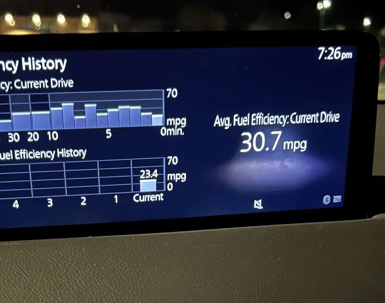

Interesting what is the specifica to get this. As almost nobody from the folks that report could reach this on their Turbo if driving in mixed mode and with the crappy ozonated fuels with corn :) In most of the US states.
Please, share the secret.
I could somewhere near that if driving only highway but the moment I do mixed drive with city traffic and it drops to 25 :( Same if driving more than 75mph
I am almost sure if I can find pure gas 93 it would be better mpg but locally I can only get 91 and its still crap gas based on my obdii monitoring.
