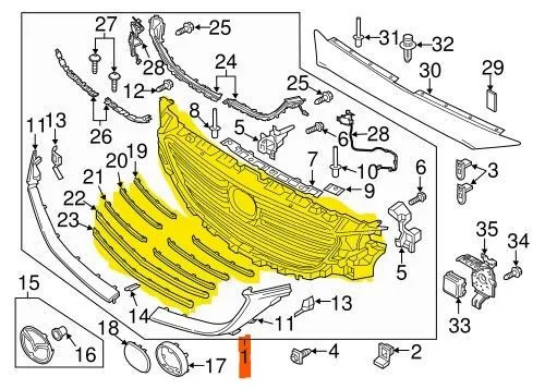

Here's a parts listing for the grille on the 2018 CX-9 Signature.
At first glance, the grille for the Carbon edition and Signature trim appear to be the same as the grilles for the other trim levels. In fact, the entire front bumper appears to be the same as the 2016 model aside from the highlighted portions below.
Ordering the Carbon edition grille would be ideal because you'd get the new grille design and the trim (11) would already be black, but I'm not sure if you'd be able to attach the existing Signature illumination parts (26, mounting bracket and 24, light bar) to the black trim. I'm actually not even sure if those parts mount to the trim at all. This means that you'd either lose the Signature lighting option, or you'd need to DIY a solution to make it work with the Carbon grille (if the lighting needs to be mounted to the black grille).
The good news is that since the Carbon grille assembly doesn't come with Signature lighting, it should cost less (probably around $320 to $350 USD, according to the 2018 parts listing).

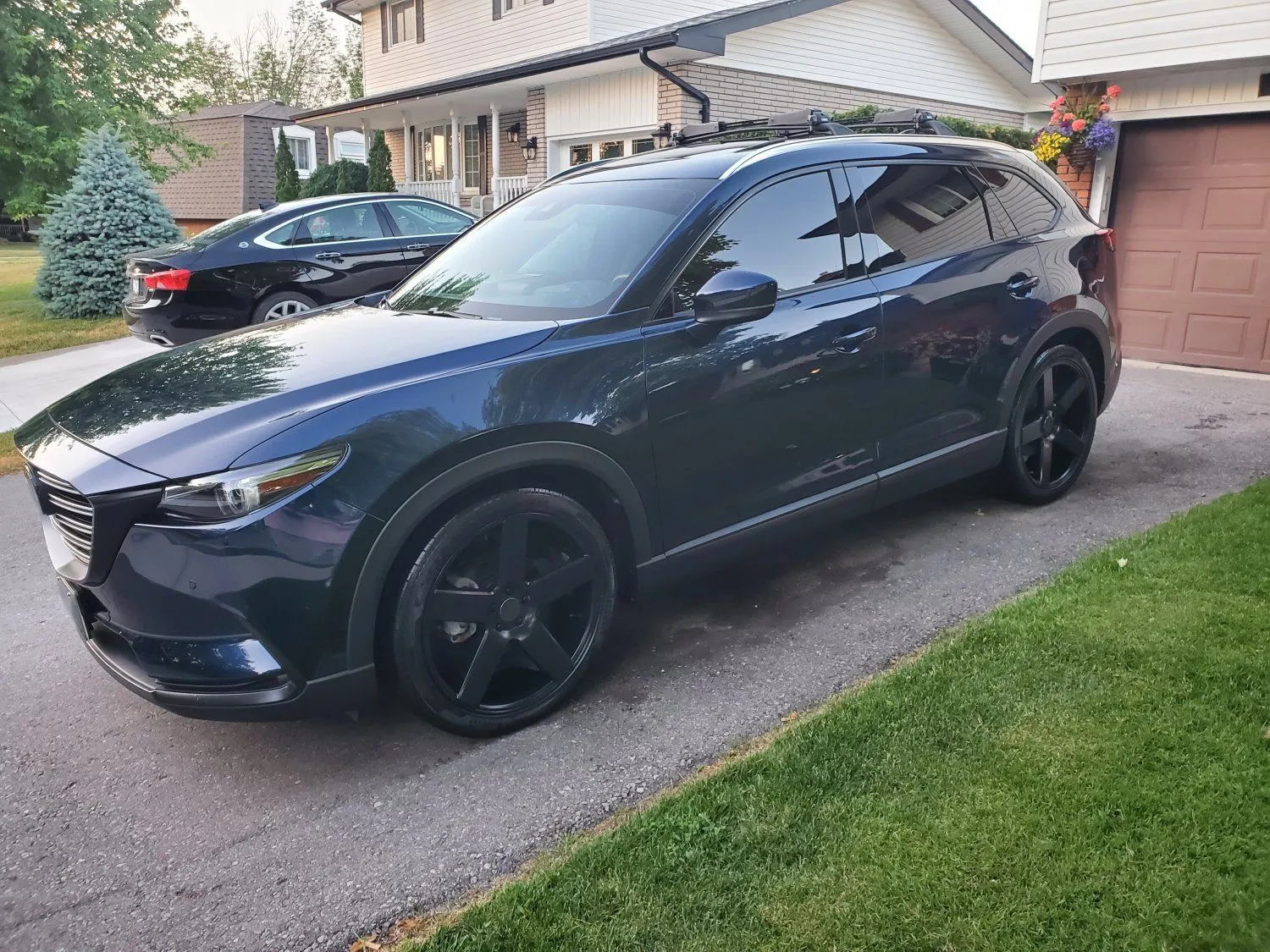

Only caught it because I got excited thinking I could buy the gloss black trim instead of trying to wrap mine. Not that lucky. Will be one the hardest spots to wrap I think.
Probably all of it. Initially thought I would leave the horizontal bars in the grille chrome, but I’m liking how the rest has turned out, so might just do everything.

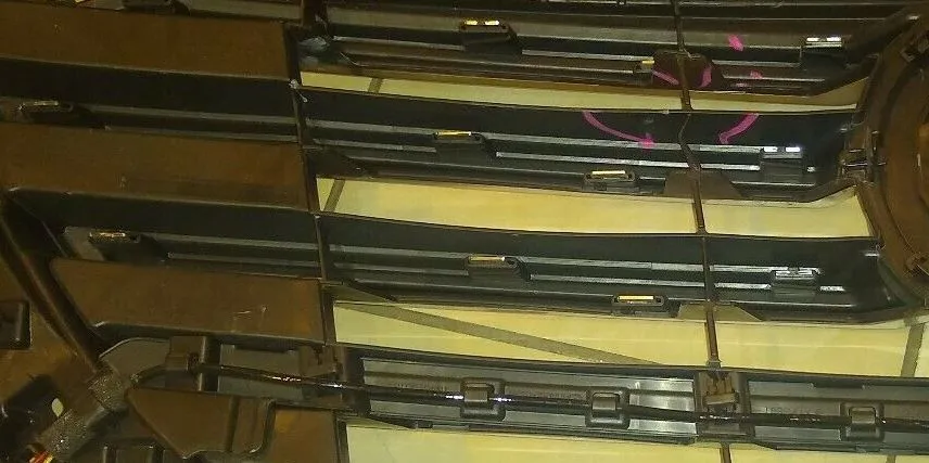

I was able to find an eBay listing that shows the back of a 2019 grille with the silver slats, and it looks like they slide into slots in the base grille. It seems that all CX-9s with this particular grille come with the same base unit, then depending on trim, the matte black or silver slats are clipped in.
I assume it's the same for the 2021s with the new grille. The silver and gloss black parts are garnishes that slot into a (possibly new?) base unit.
