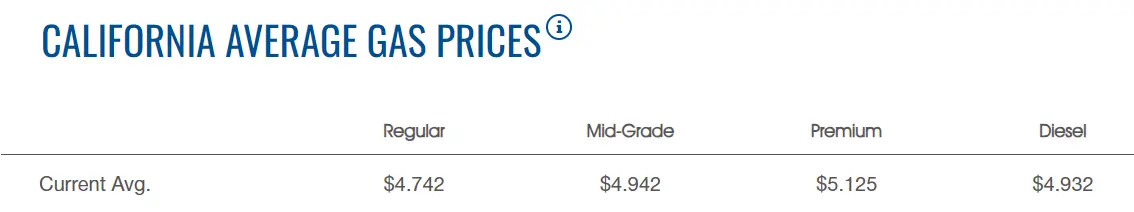

Two months ago, I started to put in 91 ( highest in CA) to check MPG.
I did not find better MPG after a few tanks of commuting (same routes).
However, I did feel better acceleration from red light (i.e. >4k RPMs).
More than static torque/horsepower curve can show (which shows higher torque >4k, hence more horsepower), but also the dynamic response of engine is better.
I have been using 91 ever since.... cost 10% more at gas pump.

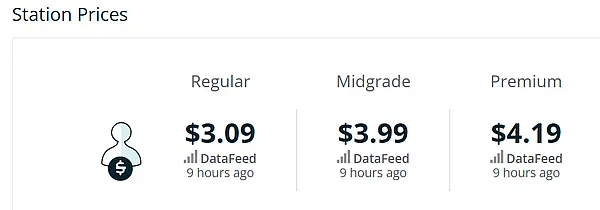

RedBaron,
Our base price ('87) is much higher... so, percentage wise, the gap is smaller. Sad.
Both of those are a much more reasonable spread (even though CA is so high).
This is from GasBuddy, just now, for our local Shell station :(

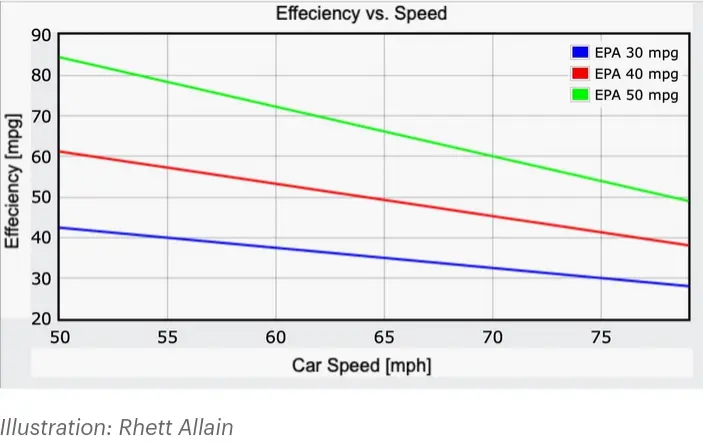

I saw this interesting article about how gas mileage at any speed can be 'inferred' by the EPA rating and this formula they derived from a study...
Am I reading it wrong, or this illustration suggests that a car reaches EPA mpg at speeds 75-80mph?
Efficiency is on the Y axis and goes down with increasing speed. But the legend is confusing...probably lacking context.
